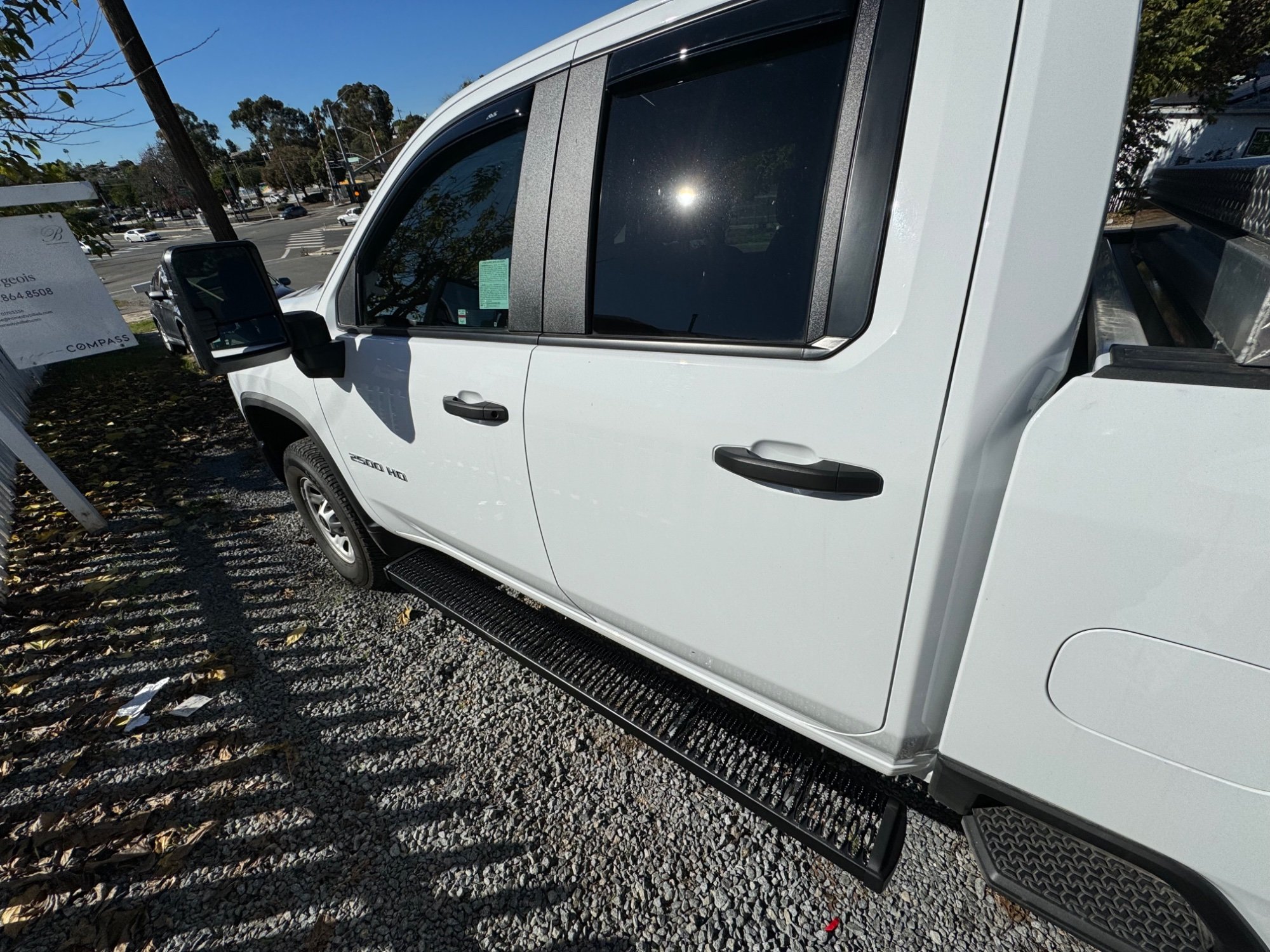

  13. Ya like it was stated above, the rocker mounts are pretty solid now. Installed these Luverne Grip Steps in about 40 minutes. No need for a helper or anything. These steps seem really well made. We will see how they do over time.
  14. They said the only option they have is the rocker mount. I really like the design of the grip step so I think I'll get them then fab some different brackets.
  15. Old thread but chasing this down for a 2024 2500 Double Cab. Put in a "contact us" to Luverne. I see on their running boards for GMT800 trucks it looks like it uses the cab mounts for brackets. I will update this thread if they are able to provide me a solution that does not mount to the rocker.
