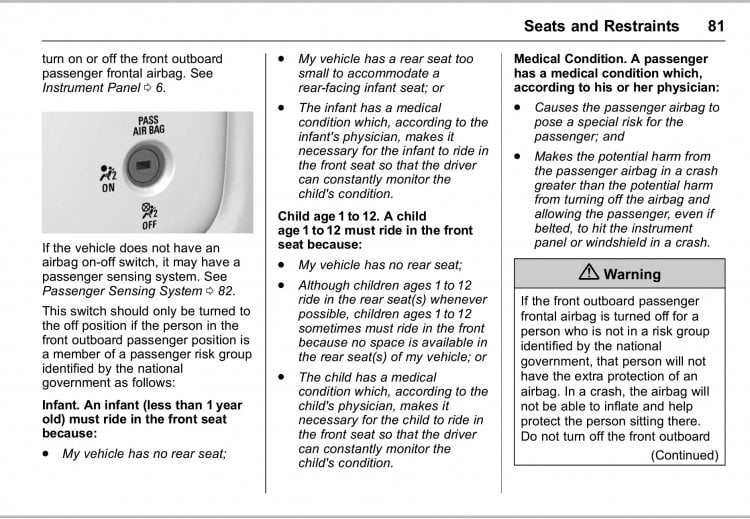

  19. Thanks for the reply. The owners manual on for the 2016 on P81 shows this manual switch to disable the airbags for passenger. I guess my High Country trim model doesnt have the option to disable passenger airbag. Not sure I need it, just was looking for it after reading the Owners Manual. Lots of gadgets to digest on the truck, almost to overload point. Wonder how non-tech savvy new owners can even deal with the infotainment system! Thanks, Bob
  20. Excuse my Silverado newbie-ness, what does K2XX mean? My owners manual mentions this is on the passenger dash end-cap. Do not see anything.
  21. I have a 2016 High Country and cannot find the keyslot to disable the front passenger airbag. My truck was initially sold in Canada so I am wondering if it doesnt exist. I have found a few subtle differences so far. Can anyone point out where it might be? Thanks, Bob
