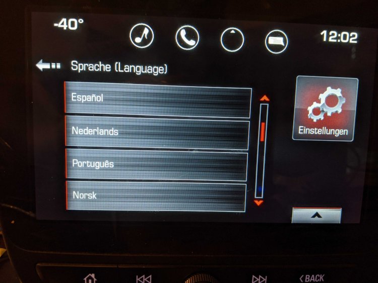

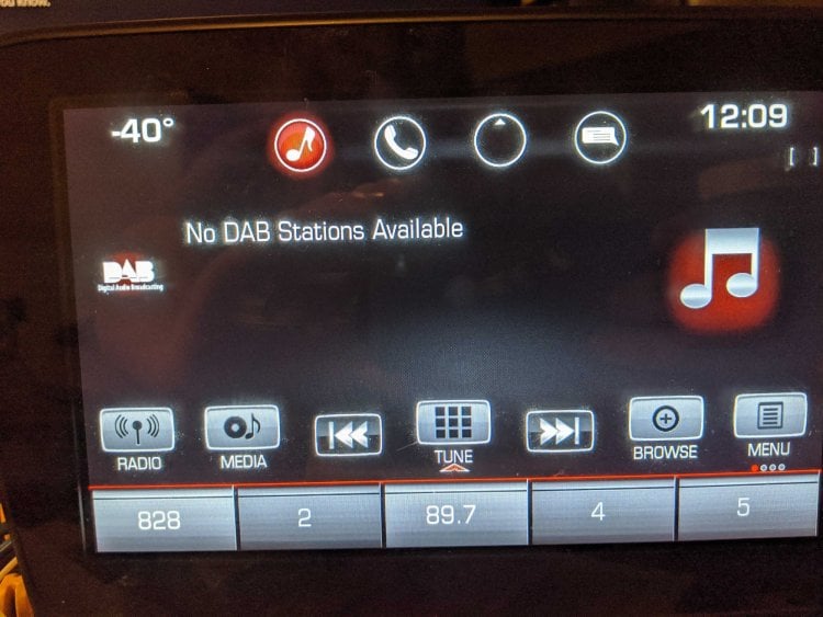

  14. Just wanted to show off a mod we recently did for someone in Germany who imported a Sierra overseas! We were able to enable DAB radio, European radio frequencies and enabled all languages. We have done a few mods for people with GM vehicles overseas - pretty cool to be able to see these different options available for vehicles from different regions.
