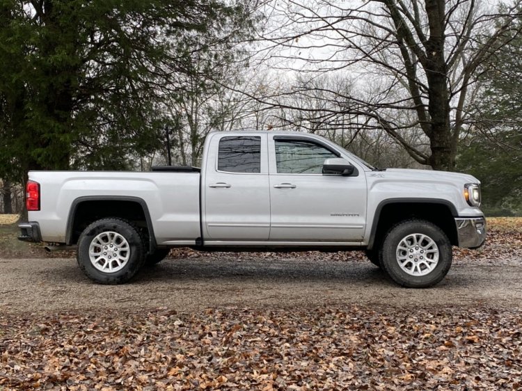

  4. May be too late to the party here, but I just installed the Halo coilovers and rear shocks on my truck. I’ll give you my thoughts if you haven’t pulled the trigger yet. I absolutely love it. Rides so much better. No more bouncing or skipping. I set mine at 2”, with one spacer on the bottom for a total of 2.5” lift in the front. Also replaced the factory UCAs with Cognitos. I’m running 275/70/18s with no rub anywhere, so I can’t attest to what it will do with 17s, but I’d bet you’ll be fine. The install was as easy as you can get. Simple remove and replace. Their product is awesome you will not be disappointed. Also, the customer support and service with these guys cannot be beat. Best I’ve ever worked with. I have since put in a MotoFab 1” rear block and I personally like the stance. Don’t have a pic with the rear blocks installed though. 2019 Limited. Before/After:

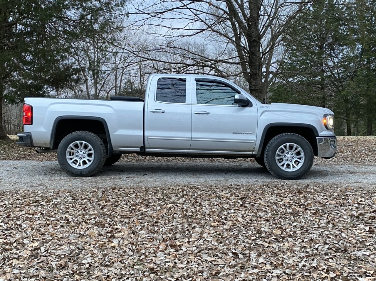

  5. 2.5” lift in front. Cognito UCAs. No rub at all. 275/70/18 tires with the stock wheels. Since these pics I’ve added a MotoFab 1” block in the rear. Before/After:

  7. Sharp truck! Curious if you put any lift blocks or add a leafs in the rear? From the pic, it looks like a slight rake, which I like.
