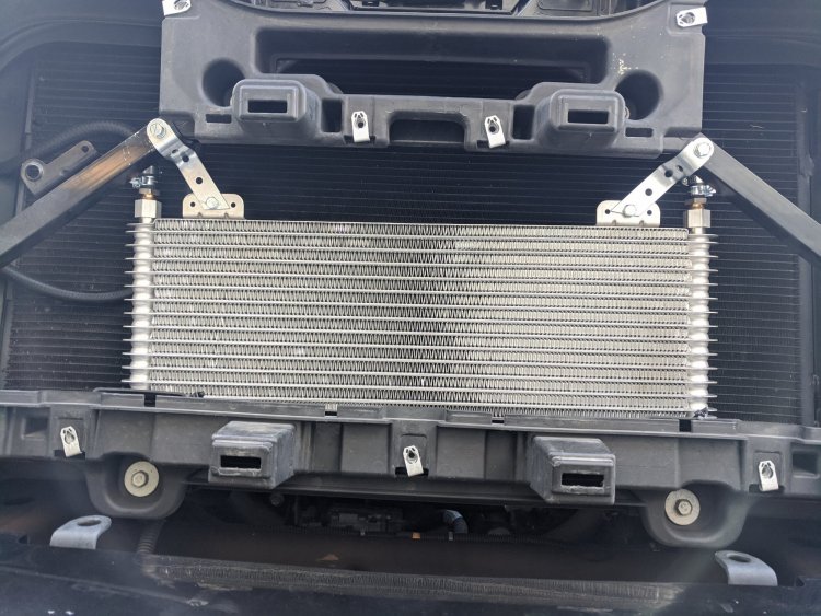

  21. added the true-cool 40k, before I added the cooler I had already deleted the transmission thermostat, with the thermostat in place originally trans temps were 190-220+ almost always, deleting the thermostat dropped it down to about 170-190, adding the true-cool dropped it to about 155 after a good little workout, just cruising it was 122-135 ambient temp was about 75deg took me a little while to get it installed this is a universal kit, it was simple enough to just pull one pipe, cut it and flare one end (discovered I don't really have skills for flaring) then fit a hose over it and clamped it, ran the hose thru the plastic, used the supplied brackets with a little bending and cutting, not all professional but it works and should remain trouble free for many years. I installed it to work in unison with the factory cooler, I did trim a couple small pieces off of the shutters for clearance even though the shutters are disabled by blackbear if I have to put the tune back to stock then it wont give me any problems blocking the shutters from working. It's only letting me upload 1 picture for some reason.
