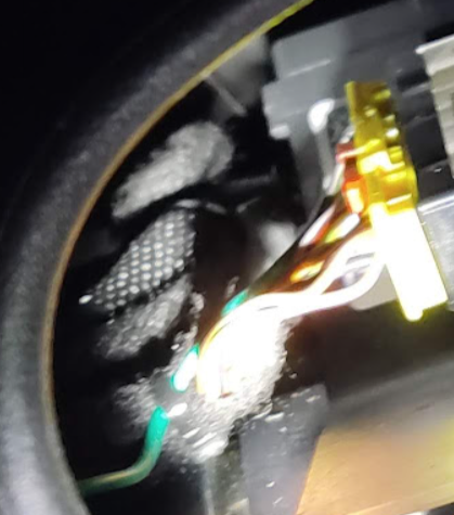

Well, it happened again and I think I found the root cause. I popped the top plastic cover off of the steering wheel column and the problem still existed. (No horn is easy to check!) I wiggled the wires on back of the yellow connector that plugs into the clockspring and ta-da, functional horn again. I started looked at the wires and noticed that the ones of the left seemed to be pulled pretty tight. I slid the red locking tab out and then removed the connector. It appears that when I added the new wire to get the updated gauge cluster to work, I accidentally twisted the entire assembly around once before plugging the connector back in. I untwisted the cable once and all of the wires looked much more relaxed. I plugged it in back in and everything worked, and the wires no longer look to be pulled tight. Let's hope that I didn't do any long term damage by having that much stress on the wires/connectors. Here's when it was twisted: Here's the more relaxed orientation: (different angle) -

In typical vehicle fashion, after work, I went out to diagnose my truck after letting it sit all day. I had printed out all of the pages of the GM upfitter electronic schematics that dealt with the horn and steering wheel controls, so I had connector and pin information that I'd need. I took off the plastic cover on the top of the steering column and before I started poking around, I decided to try the horn again, and of course it works now.... I put the key in and all of the buttons on the steering wheel also worked. I didn't see/feel anything lose, but did push on all of the connectors in there. My Pontiac G8 GT will sometimes do something similar where the radio buttons on the steering wheel stop working, but completely turning off the car (including opening/closing the door to kill the Retained Accessory Power) will make them start to work again. After looking at the schematic of the horn circuit: I'm guessing that the BCM had some sort of hiccup. Oh well, at least everything is working again! -

Well, three years after installing my new gauges and steering wheel, my truck developed a random steering wheel related problem yesterday... I went to blow the horn and it didn't work, and then I noticed the the radio controls and the right side buttons no longer work either! The cruise control buttons do still work. And when I lock the truck with the remote control, the horn still honks. I don't see an airbag warning light, so hopefully that is still functional. I didn't have time to diagnose it yet, but will be pulling the top cover off of the steering wheel to inspect the connectors, and checking my fuse panels. You guys think that I have a faulty clockspring? Maybe a connector just came loose? Is there a single fuse that controls that stuff? Thanks! -
