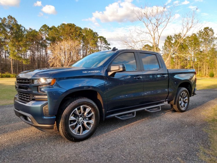

  10. Thanks Flyinwells! This was very useful in getting me started on my Blackvue install. I made a new topic with a PDF of my install and some of the issues I encountered. I also included a link back to your article as well. I am definitely going to upgrade to the mount you are using in the near future. Thanks again!
