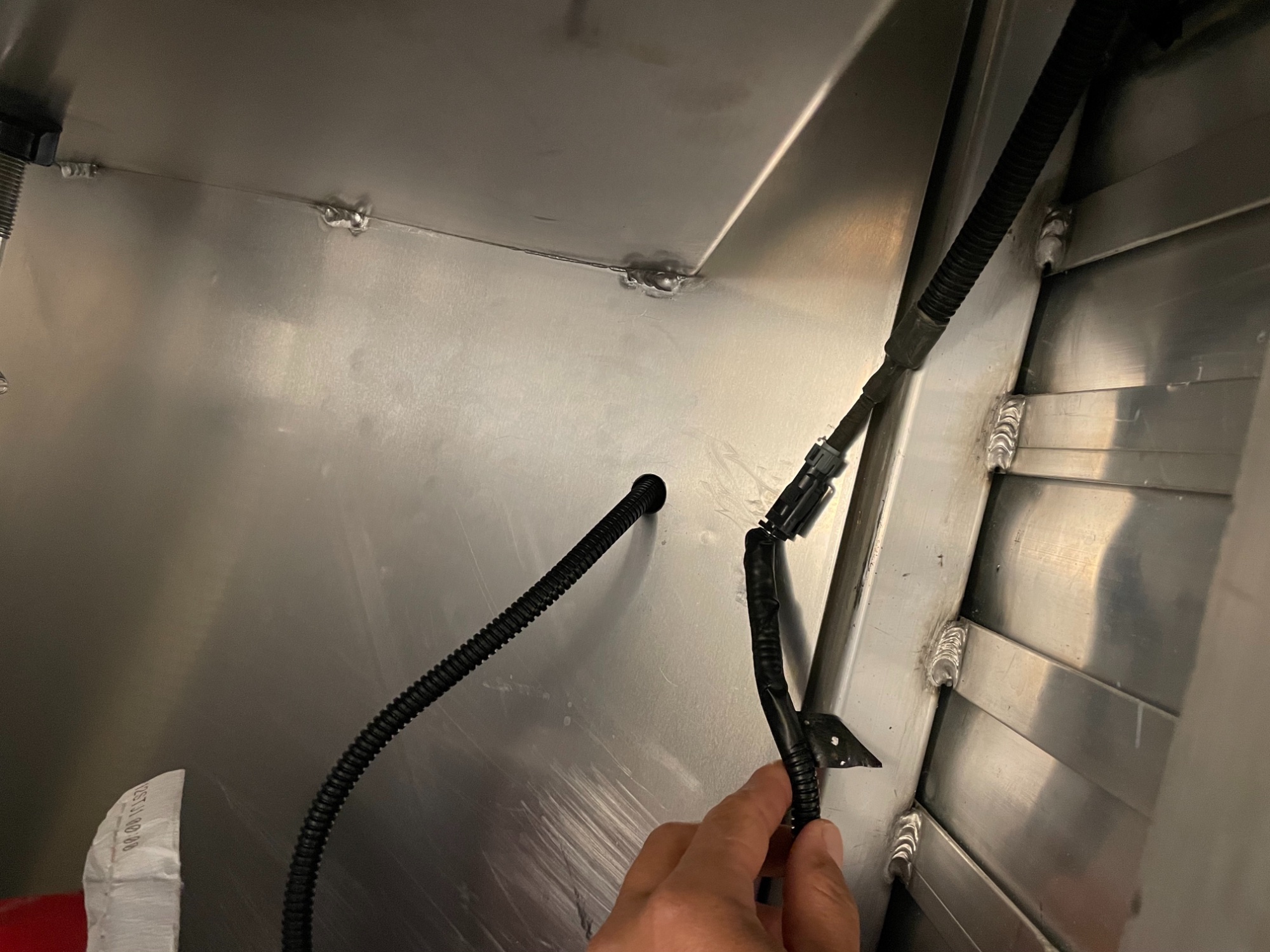

  1. That's all I needed to relocate my bumper plug into the bed. Like someone mentioned, I didn't even have to remove any bedliner (2024 Sierra 3500).

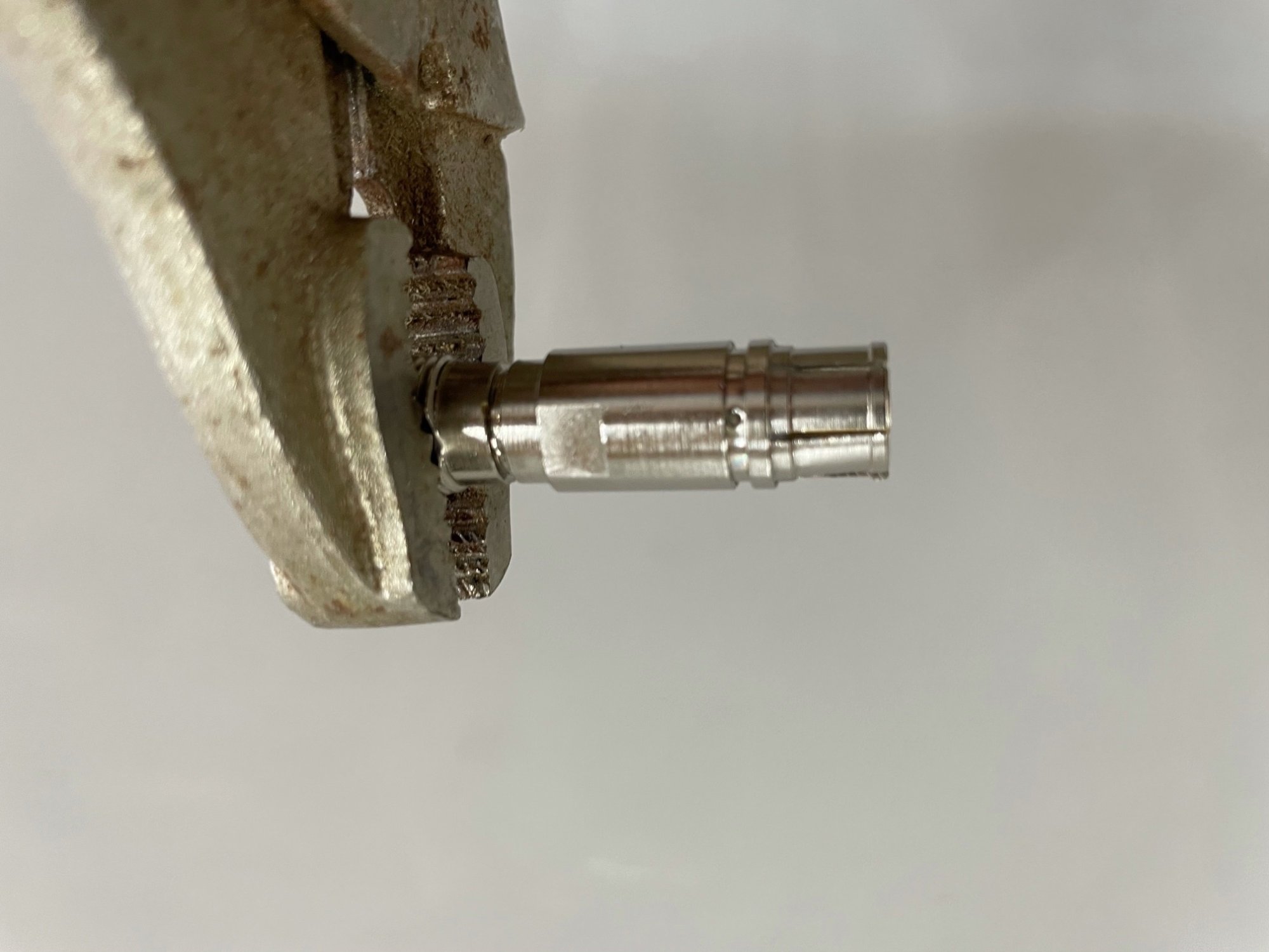

  4. My dealer placed an order for me on 1/31 using one of the HD's in their allocation. When I went in this week for an oil change, they checked on the order and couldn't find it. For some reason, it didn't go through. But, they did have another 3500 Dually in allocation with a "2000" status number (they said that's about ready to go to build - it gets a "3000" number when they start building it ultimately ending with "5000" as delivered). The general manager made a few changes to that truck to match what I wanted and they think it'll go into build in a week or two.

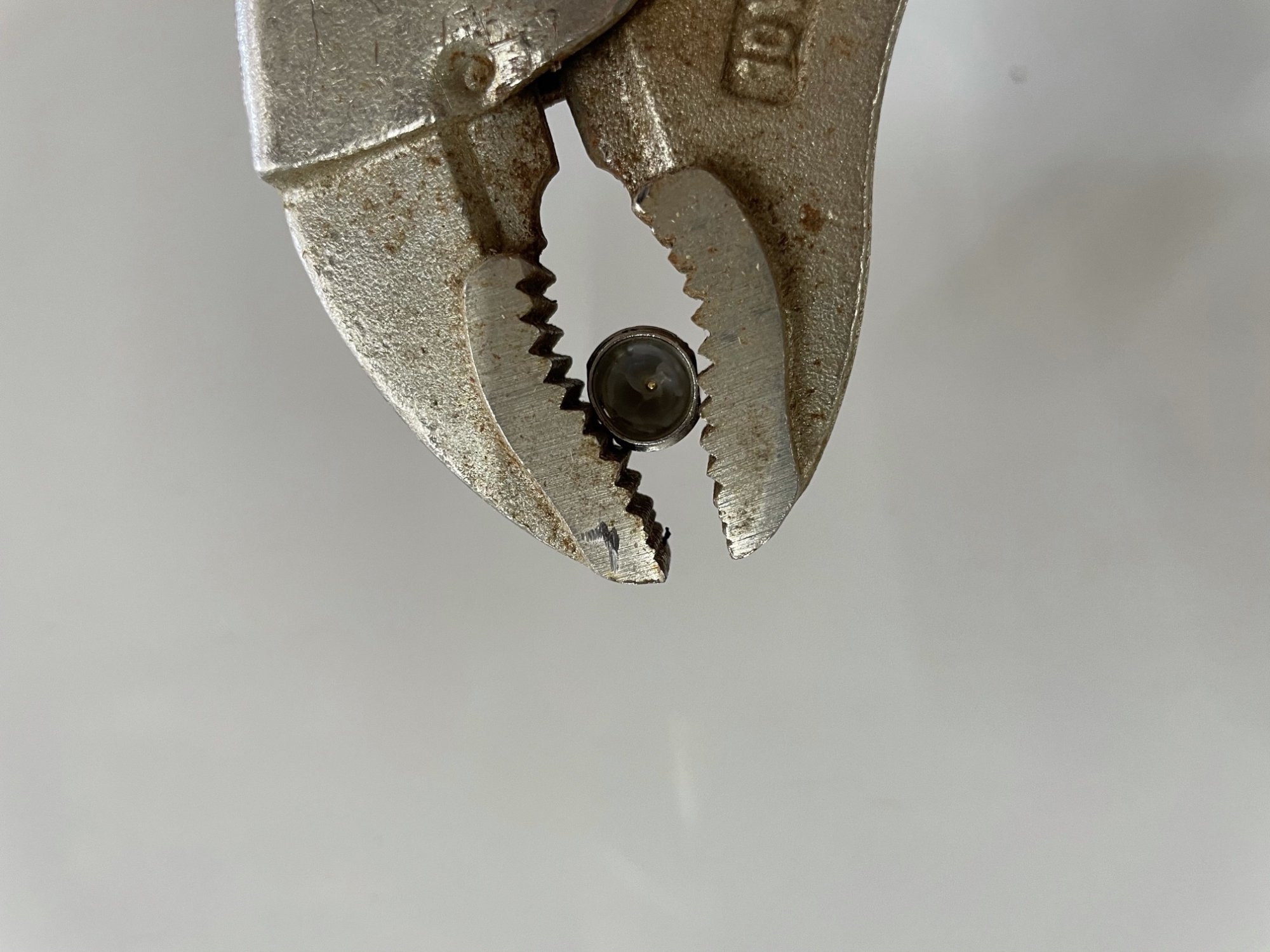

  5. The "031-14693 BACK UP TRAILER CAMERA VIDEO CABLE REPAIR END" is technically an Amphenol RF connector, part 122108RP. https://www.mouser.com/ProductDetail/Amphenol-RF/122108RP?qs=mkvzZYCyQViZOgysniBgoA%3D%3D I think the connector that goes into the bumper plug is likely a version of TNC or BNC connector. I started looking into it before but moved onto other things after I was able to re-use my bumper plug connector.

  11. Finally did my move yesterday from the bumper to the bed. Also fixed the broken cable end on the camera that snapped when I did a u-turn out of the barn with the gooseneck. I ended up pulling the "ears" on the clip outward so that they would have the more distance needed to snap into place. One of them snapped right in - the other I had to get underneath with a long screwdriver and pulled at it until it also snapped into place.

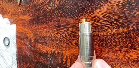

  13. I was able to get the pin in the connector reset back to the correct position. Just applied a little heat and used a wire to push it back and held it there while the connector cooled off.
  14. I recommend the grinder method. Applying heat did not loosen the connector in any way. But, it did manage to melt the plastic inside the black connector and the pin is not centered and is sticking out of the connector when it was flush. Once I had the coax connector off, I could remove the c-pin and remove the metal connector from the outer black plastic holder. There are no part numbers or anything to identify this piece. Going to try heat again and seeing if I could push that pin back into place...
