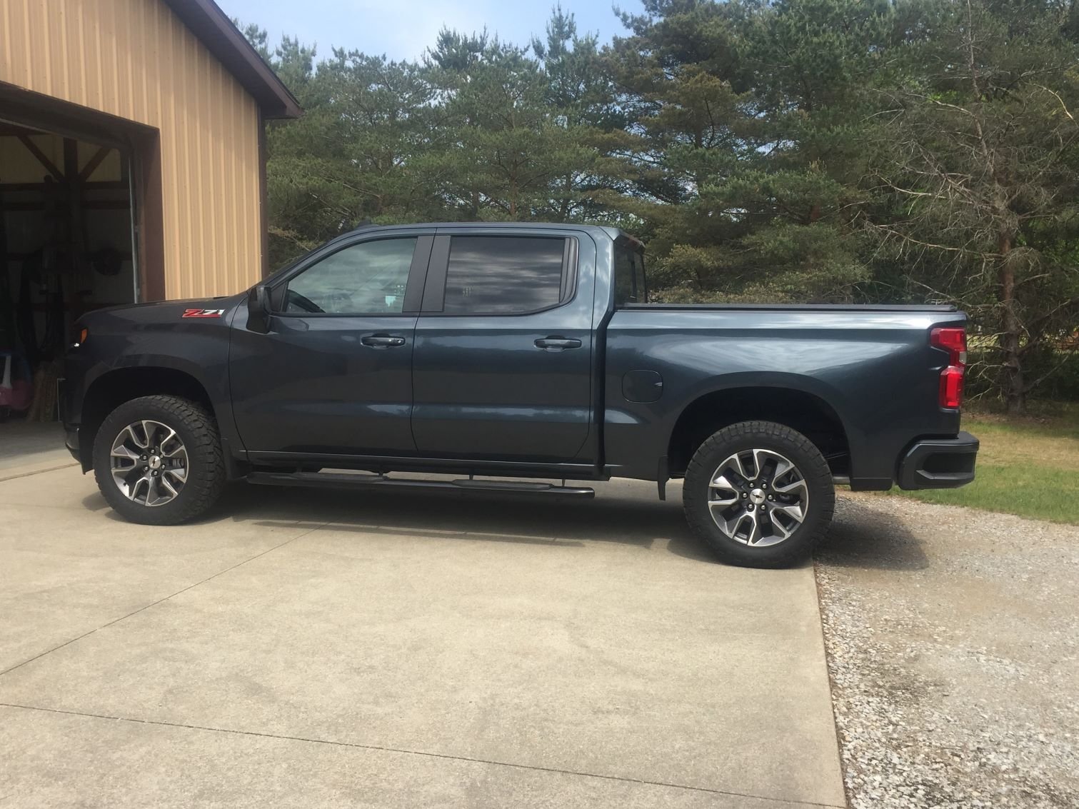

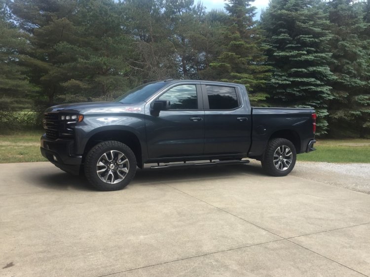

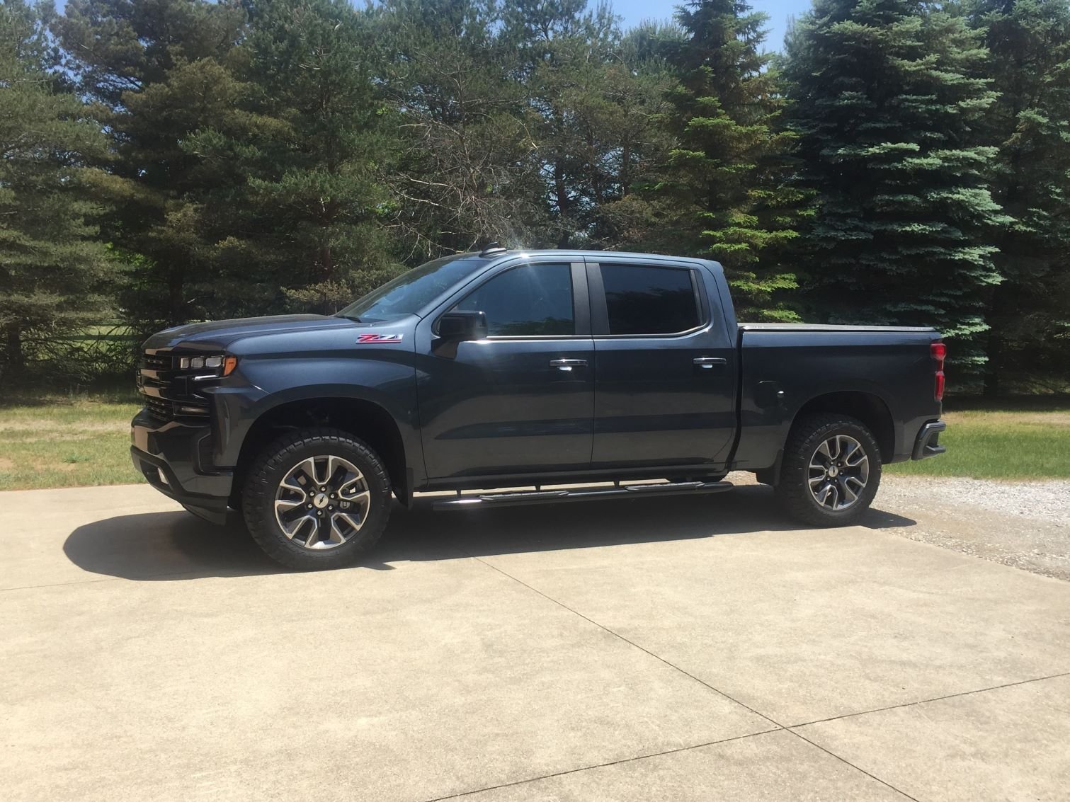

  1. Sorry about the late reply. I did. First two photos are after the 1" rear block install, the last two just the front Bilstein leveling shocks.
  2. Looks good! Amazing what an 1" - 2" will do for looks. Any noticeable improvement in ride yet?
  3. Thanks, it was the exact look I was going for as well. I have a 1" rear block coming, but not totally sure if I will put it in or not. I need to do some more measuring. I'll put a jack under the rear hitch and raise it that inch and see what it looks like first. From one angle, the front is noticeably higher than the rear, but other angles it looks good. It rides significantly better with the Bilstein 5100's, the difference was instantly noticeable. I believe I have the 4 ply tires? I went with the cheaper, lower load rating if that helps. I wanted 285/60/20, but that meant spending another $4-500 in just the difference from 275 to 285 and couldn't justify it. I saved the tire cost and put it into the Bilstein's.

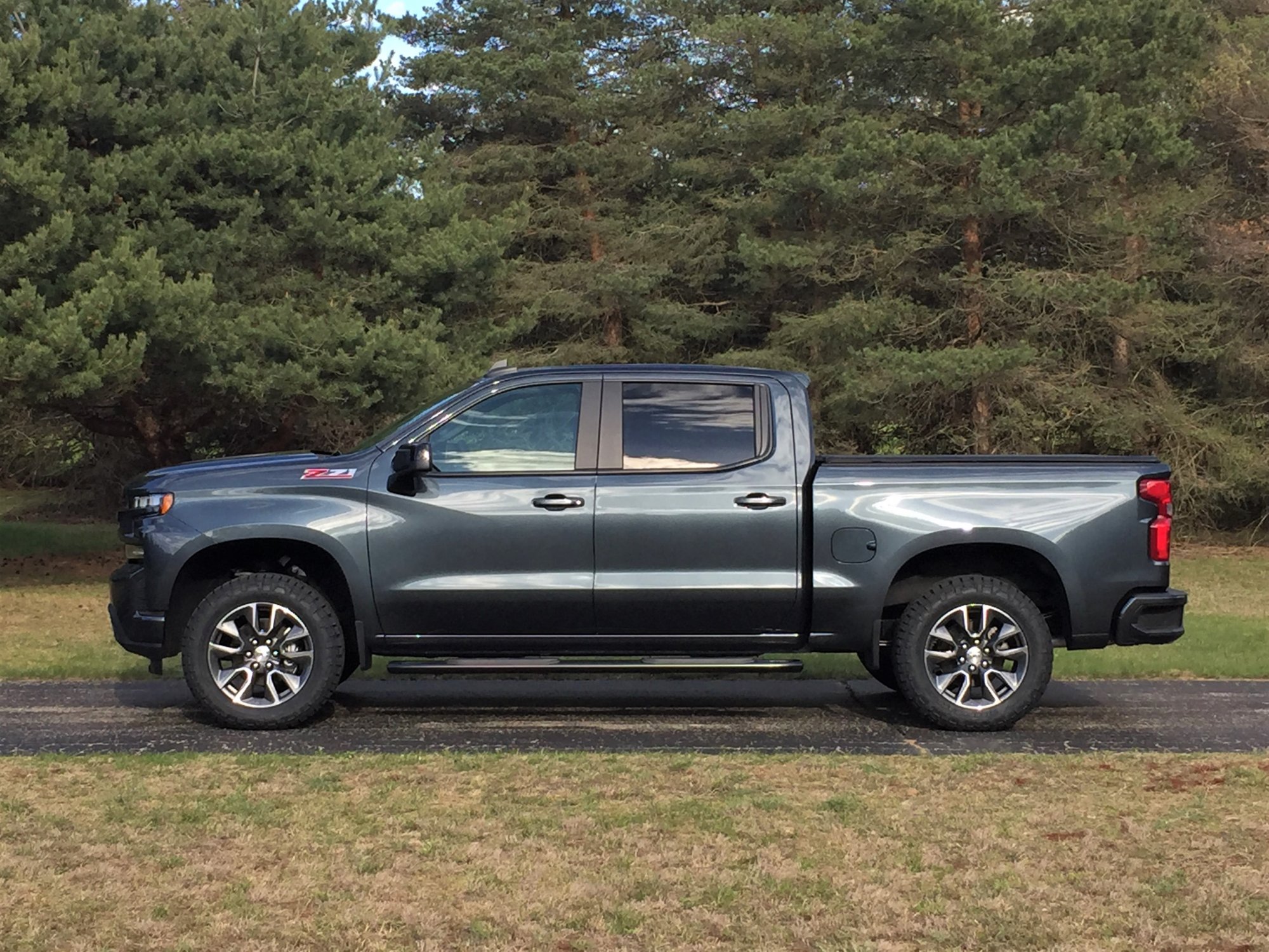

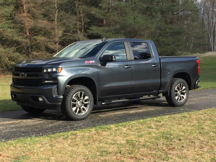

  5. Had Bilstein 5100's installed in the front and rear. Front set at 2". Swapped out the stock tires for Ridge Grapplers, 275/60/20. Also had a Flowmaster FlowFX Muffler installed. 1" rear block on the way to level out the rear and give it a touch of rake again.
  6. 2021 RST Z71. 265/60/20 Ridge Grapplers. Stock wheels. Bilstein 5100's all the way around. Front set in groove #5, 2" setting.
  7. Here's a couple photos for reference.
