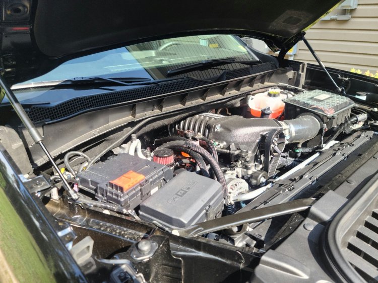

  1. I have a 2021 6.2L TrailBoss and I have added a 3.0L Whipple Supercharger and ECU unlocked by HP Tuners. All the work and dyno tuning has been done by National Speed Inc. They have been able to squeeze 580whp which is pretty close to 700hp at the crank. My truck will keep up with my 2015 C7 Corvette Stingray. To my knowledge HP Tuners has recently been able to unlock the GM 10spd tcm. My shop has confirmed it and they want to wait until HP Tuners offers more adjustability. Currently there is not much that can be done to the tcm even though it is unlocked. I have only had one problem with this setup. After about 5K miles the pulley and main shaft snapped in half while cruising on the interstate at 75mph. Whipple and National speed obviously fixed it for free as it was all still under warranty. If anyone has any questions I'd be happy to help. I'm going to attach the dyno report.

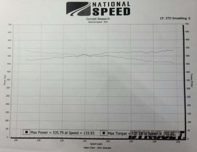

  2. Here's my dyno print out... 535whp and 537lbft.

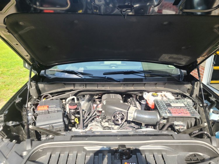

  7. I have a 2021 6.2L TrailBoss with the 3.0L Whipple. GM performance upgrade package which was the air intake and cat-back exhaust. I had the work done by National Speed Inc. They dyno tuned it to 535whp. I too have the trans issues with the truck. Nothing major but a little stumble once in awhile. Until we can get the 10 speed unlocked I believe it is what it is. I really have no complaints. The truck runs the ¼ mile just as fast as my 2015 C7 Corvette Stingray and that's on the stock 265/60R20 tires. A full size (5,300+ lbs) truck running the ¼ mile in the 12s is an awesome experience. The truck just rolled over 2,000 miles.
