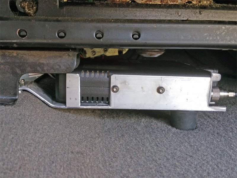

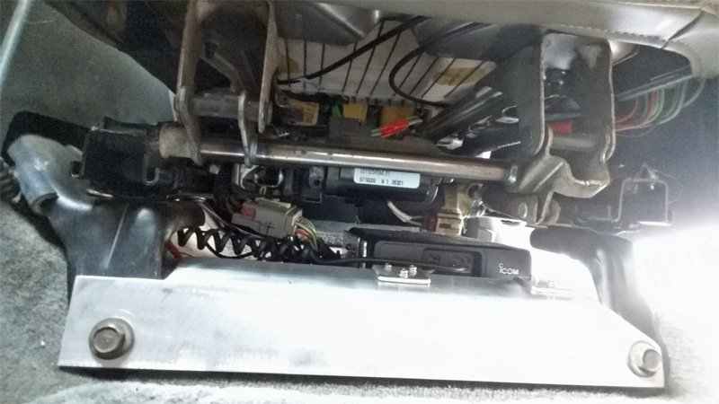

Thanks tbully. I really like the fender mount position, and will get with the company who is making them to see if they have a version for our newer trucks. If that doesn't work out, I'll be putting a roof rack on the truck, so I can always mount the antenna up there. Center of the roof is an excellent place (probably the best for ground plane) for an antenna. If I wasn't doing the roof rack, I'd probably do the same as you. Mounting the radio under the seat in the Dodge worked great because it had good air flow. Hence why I'll probably do the same on the Chevy. It was a bit better protected in the Dodge as the foot well area was lower, so I'll need to make a front plate to protect it. Will post up how that works out when it's done. -

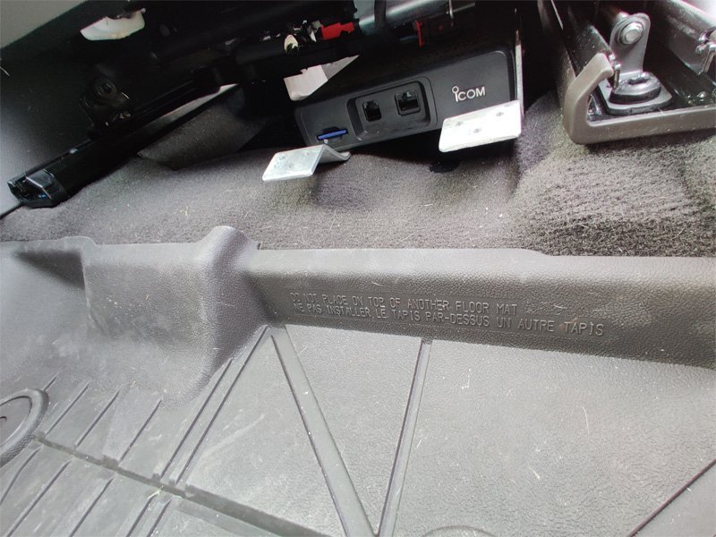

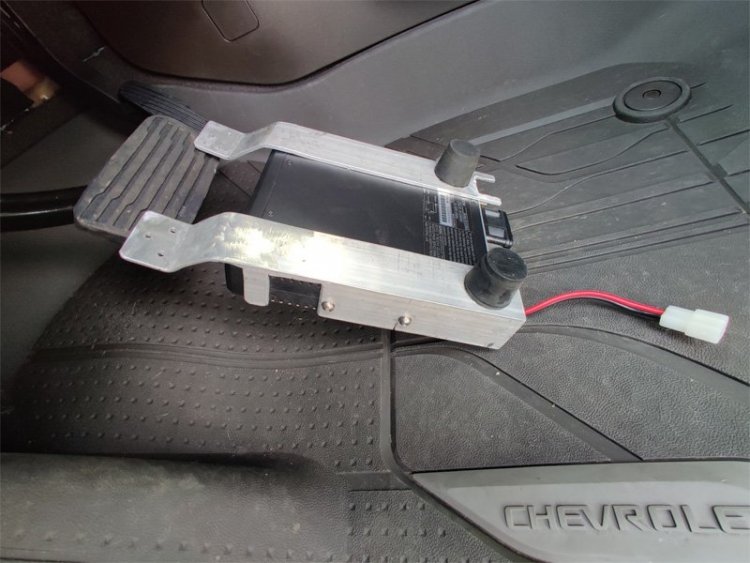

What have you guys done to mount a Ham / Commercial radio in your 2020+ HD trucks? I'm going to start working on this in a few weeks, and would really like to see what you have done. I'll be moving an Icom ID-5100 from the Ram into a '22 3500HD Crew Cab. The ram was an easy install, the floor under the driver's seat is flat. The Chevy is a bit different with the rear floor heater duct. Most of what was made for the Dodge will work in the Chevy, sans the piece that ties across the front seat mount bolts. In the Chevy I can use a piece of 5mm aluminum flat bar 1" wide that runs across those two seat mounting spots, under the seat frame. I'll need to space one of the rubber bumpers down about an inch to get the rear to sit supported. The antenna will be tougher. I don't think the earlier fender mount will work, so I need to look into that further. Picture of the fender with the green drawing is what I was thinking. That is how the NMO antenna mount worked in the dodge, It was really nice for going through car washes, as I could quickly remove the antenna and put a cap on the NMO mount. I'll use the same ProClip mount as tbully used in the other thread:

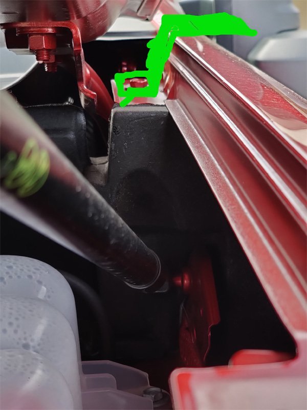

On the whistle noise: There is a thread on this forum where a few guys were working to determine the whistle that comes from the hood area of the GMC. One of the guys was using painter's tape to figure out the noise, and a way to resolve. There were pictures posted in the thread of where the tape was applied. Can't find that thread now. Not sure if it was in troubleshooting, or the general forum. From the thread it seems the noise is specific to the Sierra/Denali, not Silverado due to the difference in grill/hood. ETA: Found the thread. Hope it is helpful.
