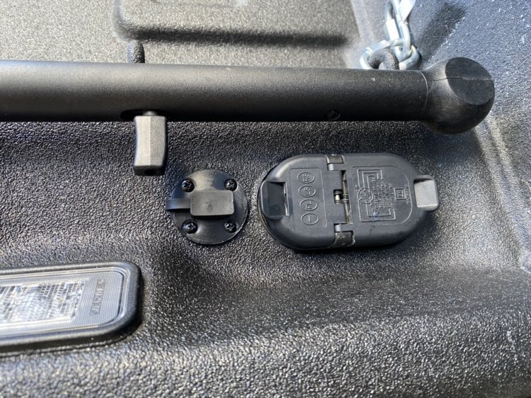

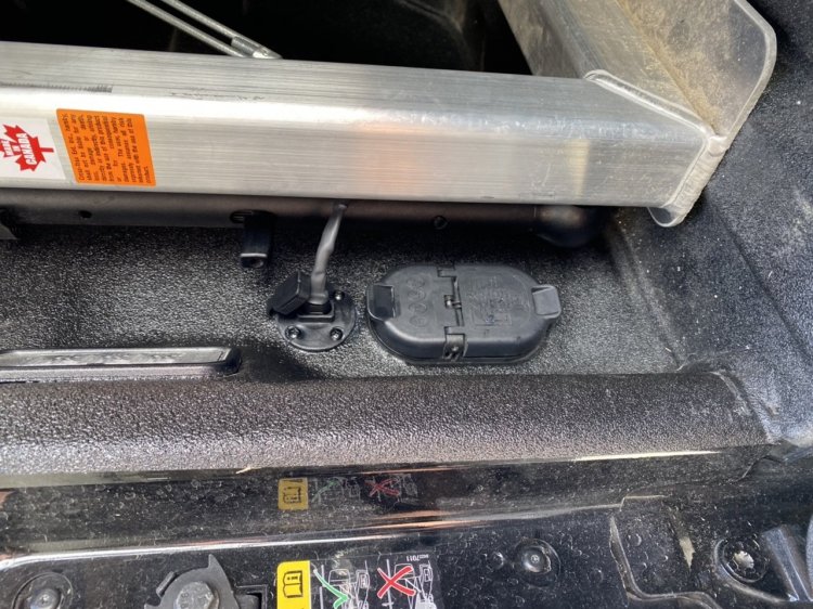

  14. I’m running the 8’ box on a long box truck. Then also added this plug and wired into my tail light for a nice clean factory look.

  21. I had the same issue with my 2020 3500HD denali I got this plug on amazon and wired into the taillight as the 7pin with resistors made the truck think I had a trailer on and would disable backup sensors and always show the camera side view when signaling.
