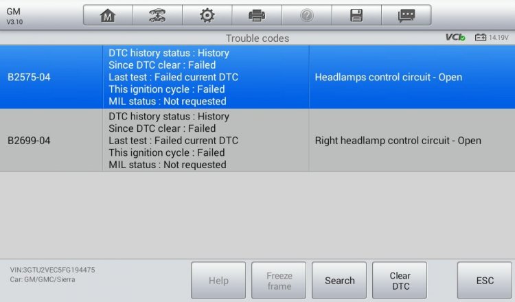

Has anybody encountered DTC B2575-04 and B2699-04 after doing your HID retrofit? All the research leads me to believe the BCM needs to be calibrated or something. I’ve replaced my harness and ballast. The lights have have been working but I’ve been getting a monthly On Star report that both bulbs are out for quite a while, but I’ve recently started experiencing misfires on one side or the other. Have to turn lights off and on a few times to get both to come on.- 3,363 replies
