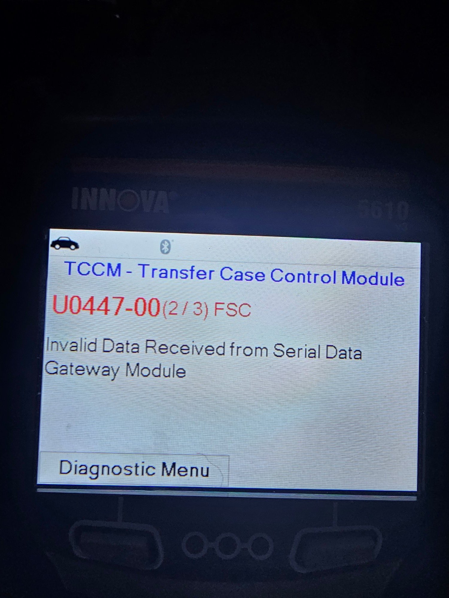

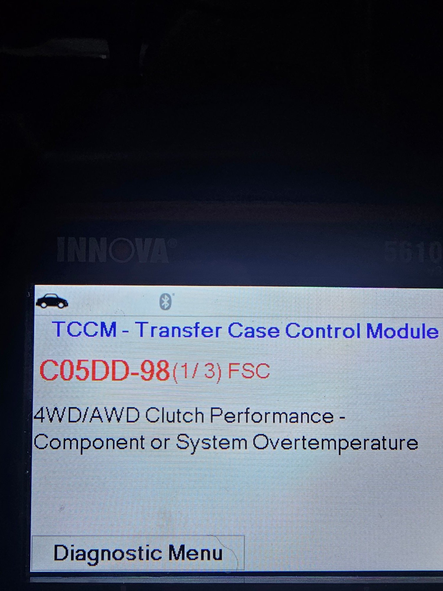

  6. I scanned every module in the truck this is what it started as. After deleting the codes, only one remains C118D-13.
  7. That is the plan when I get home.
  8. Truck is a 2023 LTZ 6.2 SBCC. I was driving down the highway at about 45-50mph (extremely bad conditions here in Michigan currently) , I took the truck out of Auto back into 2H. I got a service 4wd message. I drove home in 2H. Parked the truck in my driveway and looked the issue up on the net. It said it may need to be re-programmed, frozen parts, broken parts. I tried to drive forward, the e- brake was locked on and still had the service 4wd message. I finally was able to get into my garage while brakes still locked. I let it warm up, the brake issue went away. I still do not have 4wd. Any ideas?
