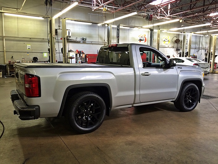

  2. Not mine, too rich for my blood haha. I am a technician at Acura, its the first one we've gotten in. only $201,200

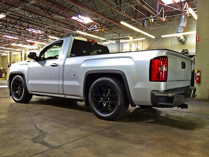

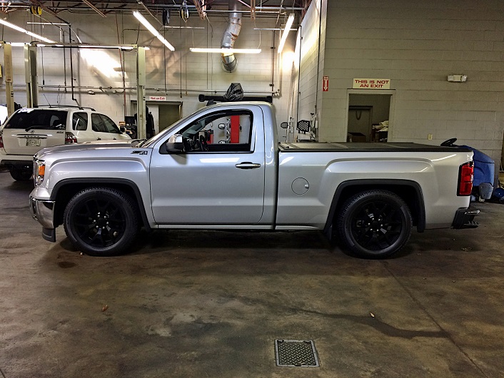

  3. 4wd. had it in the shop this past weekend making some adjustments. sat about a 1/4" lower on the LF so I made up some spacers to even it up. the RR was also alittle higher so I brought it down raising the opposite corner. Rides and drives great, no rubbing except full lock, barely touches the fender liners on large interstate bridge overpasses

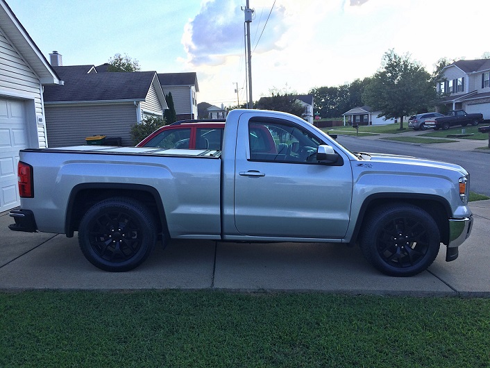

  5. ended up being about a 4.5/7 drop being a Z71. DJM 3" drop arms with Belltech front springs set on 1 inch. raised up about a half inch. rear is a DJM 6 inch flip kit with the shorter 1 inch shackle and Belltech nitro drop 2 shocks

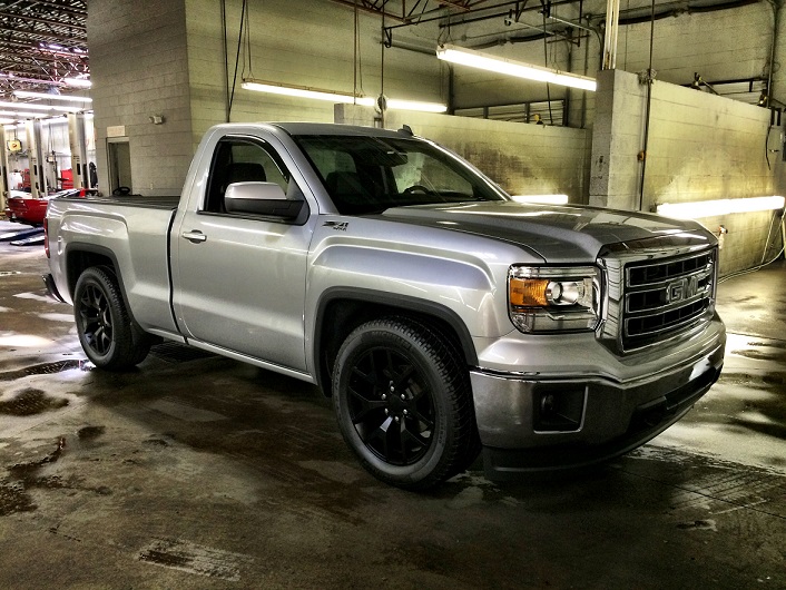

  6. yessir, if I would have known I was going to drop it this much I would have opted for a little lower profile tire but it really isn't that bad, it barely rubs

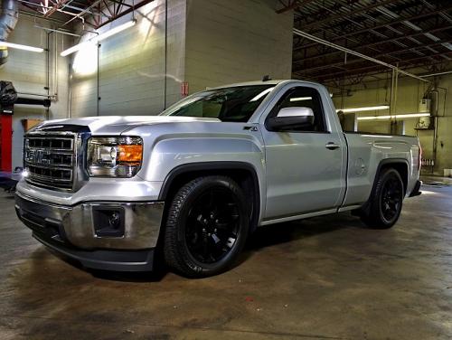

  10. decided to play around with some parts to get the truck down alittle more. 4.5/7 according to all of my measurements from when I first started with it. actually went too low in the front, had to space it up...still may bring it up a 1/4' or so. only issue is the top of the tire hits the fender liner on larger freeway bridge transitions (few of them in my daily route) other then that only full lock rubs...not on the fender liner but actually the inner lip of the rim touches the upper control arm. some wheel spacers will take care of that. no issues what so ever with 4wd. the rear driveshaft is now flat, plenty of clearance everywhere but need to play with the pinion angle still, getting a vibration for the first time at 70 and above. ride is not compromised in fact I believe it rides better then before. Probably should go to the next step shorter nitro drop 2 rear shocks since they are pretty compressed. That's it for me this time, its as low as it goes haha doesn't even look like the same truck anymore
