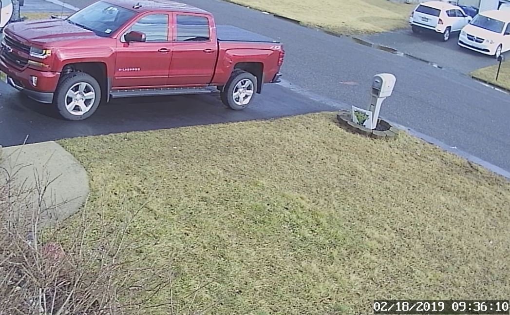

  4. Nice clean front wheel on my security camera the morning I dropped the truck off..... I should have taken a photo of the wheel before I cleaned it but I didn't, but there was black grease streaking out between the spokes. Had the truck backed in since we've had it home, we always back it in, but it was pulled in nose first earlier this week from when I had installed some amber marker lights in the grille (that's another thread). So I have some evidence that suggests the puncture and grease leak might have happened at the dealer..... what the hell.....

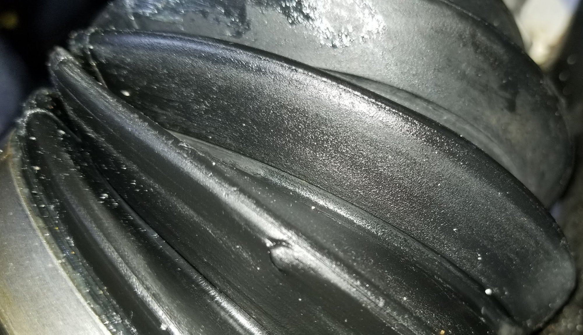

  5. Can't catch a damn break here. Called all around for a replacement CV boot, nowhere has it aftermarket, GM boot is $88 for the boot, bands and grease. I already have the axle out so I said screw it and dropped the $95 with tax. Turns out the large band clamp does not use the usual ears, but some GM contraption that sits in a vice and compresses the entire solid ring onto the large end of the boot. Of course nobody has it locally. Additionally, there is no way the strut spacers caused this issue, it's a puncture. picture below. Anyway, after determining that this wasn't going back together today, I hit up Rockauto and got the entire damn replacement axle for $88 with tax and shipping, which is $7 less that I got hit for on just the damn boot from GM. Taking that back, prob get hit with a restocking fee. The other local dealer I called also said that GM has been swapping out the entire axle shaft under warranty in cases of boot tears. Which is why they don't have the clamp tool on hand, they have never had to use one. The more I think about this entire experience with this service department (purchasing dealer), the more aggravated I get. They didn't bother even checking where the grease was coming from, just said the boot must have split from the lift blocks. The boot is super soft, its a 2018 with 2500 miles on it, I don't think I could split it if I tried at this point. They also fast talked me into believing that this grease leak was somehow causing the vibration. I am really kind of wondering if they poked the damn boot and then just expected that I would pay for the axle repair out of pocket since they were blaming it on the spacers. That boot is always spinning, I would expect a tear in it if I hit anyting on the road. This is a puncture. The front wheel is also covered in grease, something I am 99.9% sure that was not there when I dropped the truck off or any time before, my wife or I would have noticed. it. The whole experience just leaves a bad feeling. New axle should be here mid week, hopefully done with this after that.
  6. Fixed. Dealer did not fix it. Picked up the truck. Dealer had me under the truck and said the vibration was coming from the front end. Showed me that the driver side CV boot has a split/leak and it's flinging grease, and said that the increased angle with the front lift spacers is causing the vibration and the split boot. Could not argue with him there. Running 3" top-mount spacers. I had read about the stress on the ball joints when running 3" spacers, but I don't off road with it. So I took the risk. Never read anything about CV issues. So I told them I'd address the cracked boot and the axle if needed and pull the spacers, paid my unexpected $80 for the diagnostic (that sucked) and went on my way. Driving home, I get to thinking about the front axles spinning on the highway, and I look down and notice I'm in 4WD AUTO. I flip it back into 2WD and sure as shit, absolutely no more vibration. No shit, wasn't supposed to be in Auto all the time, especially at full throttle at 70mph. So, basically paid $80 to be told I split a CV boot that actually has nothing to do with the vibration I brought it in for. I'm easily at fault here, I left it in auto, I lifted the front end, etc, etc. I do have a bit of a bad taste though about dropping the unexpected $80 and nobody there noticing in 50 mile of test drives that it was in 4wd auto. Again, neither did I until I started thinking about the front of the truck as opposed to the rear, but I'm not a paid tech. Moral of the story, don't stay in 4wd auto.

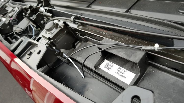

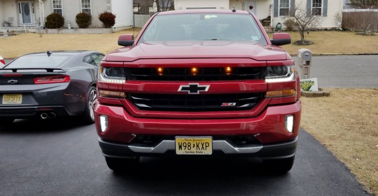

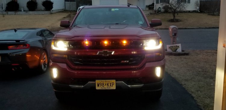

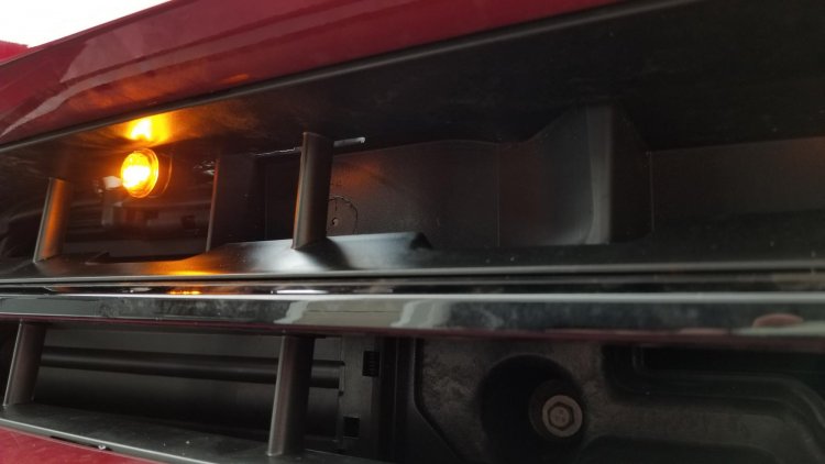

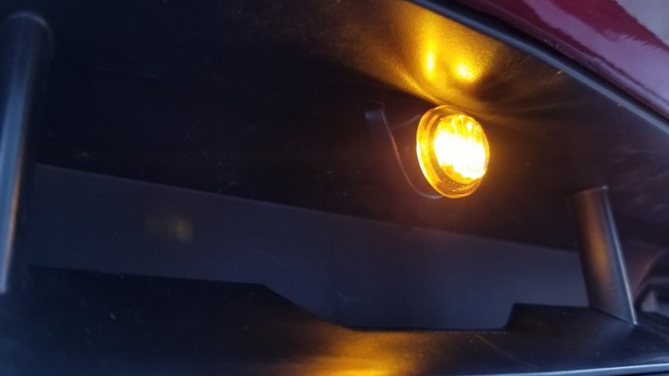

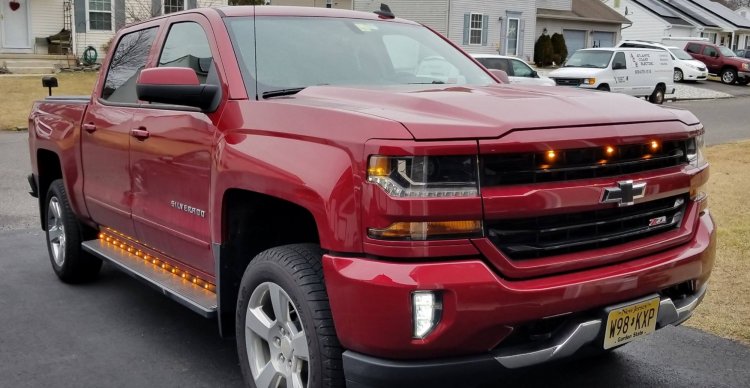

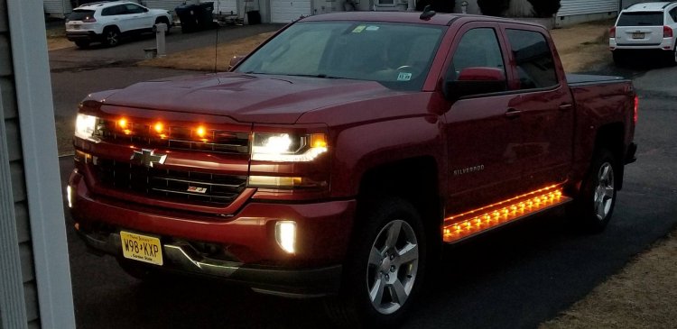

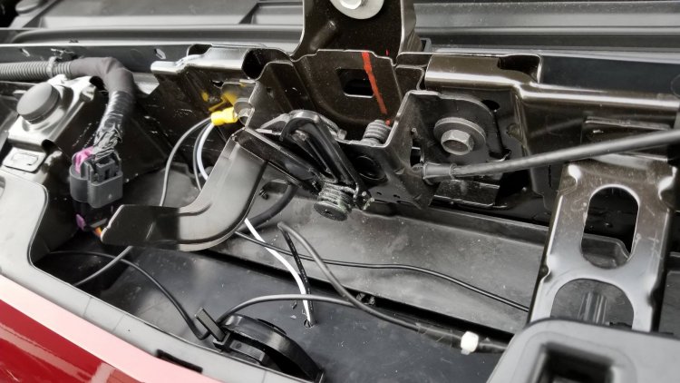

  19. Bought a bag of 50 of these 3/4" LED marker lights to do my running boards. Had 20 left over. They cost about $0.60 each (bag of 50 of them is $29.99 on Amazon). Wanted to put some Raptor style grille lights on our new Z71. Easy install. removed the plastic trim cover that goes over the radiator/hood latch area, just plastic push pins hold it in place. Then drilled two 1/4" or so holes down from the top of the grille / shroud area down into the top of the grille for a zip tie. placed a 1/4" X 1/2" strip of 3M VHB double sided tape on the LED light and then used the zip tie in combination with the double sided tape to secure the lights to the top of the grille opening as you see in the pics. Ran all 3 grounds together and grounded them on the hood latch bolt. Ran the +12 feed to the trailer fuse (#15 I think) in the fuse box. I like them a bit more spread out than a lot of the other ones you see installed. Very happy with the results.
