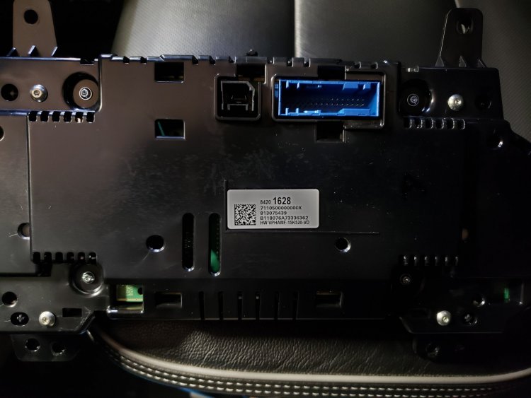

@cva617680 since this is a factory option, this shouldn't be too difficult to add depending on how mechanically inclined your are and how much money you're willing to spend. I assume all you should need is the HUD unit, up-level cluster (if you don't already have it), HUD switch, HUD dash cover/hood, instrument cluster bezel, wiring and programming. I don't know if @pgamboa has made a harness for this for the T1s like he did for the K2s but if he hasn't, purchase the dash harness for a pickup that has HUD and at least the same options that you currently have. WAMS offers programming for the up-level instrument cluster so that shouldn't be difficult. Reach out to Phil for the potential harness at: https://harnessdr.com/ and Chris for the programming at: https://www.whiteautoandmedia.com/ Source the needed parts using a VIN from a pickup that already has HUD and go from there. -
@pgamboa recently purchased a T1 and I'm sure he's in the process of developing a harness to streamline this (if he hasn't already) as he did all of this for the K2s. Reach out to him via his website. https://harnessdr.com/ Regarding the factory sub, unlike the 900 series trucks with the Bose amp in the console, the T1s have the Bose amp on the rear wall like the K2s. Since that is the case, I assume the sub connector is part of the body harness that runs all under the carpet. If that is the case, to add the factory sub, you'd just have the add 2 wires from the connector at the amp and run it under the seal plates/carpet/passenger seat to the console, just like on the K2s with you sourcing the opposite sub connector, the corresponding terminals for both connectors and obviously the wiring. I don't know if they made different amps though, i.e. one with a sub out put and another without. If they did make different amps in that aspect, then you'd need a different amp as well. IMO, if you're going to go through all that work and depending on your end goal(s), I'd recommend adding an aftermarket sub as it will sound and perform better than the OEM sub any day. Most parts guys aren't smart enough to remove filters to find parts. If you gave them your VIN, they won't find it without removing the filters. Just as @Chris Stierman mentioned above, as long as you don't have the floor 4wd selector, you should be able to get one unless they are still dealing with backorder issues.

@chevyzr1 here's my cluster. As I previously mentioned, when I have a chance, I'll try to wire in Phil's harness and see if it all works before I go any further.

@chevyzr1, thanks for posting. I was hoping to have a chance to pull my cluster sometime this weekend. I'll post my findings once I get it out.

You got me thinking about the HUD now. I have a diesel and had Chris program my UHS cluster for HUD about 3 1/2 years ago and I am 99% sure my cluster had the open/unused port on the back for the HUD. I guess I need to double check and if so, wire in Phil's harness I bought and just plug it in to see if it works before I go cutting anything. Thanks.
