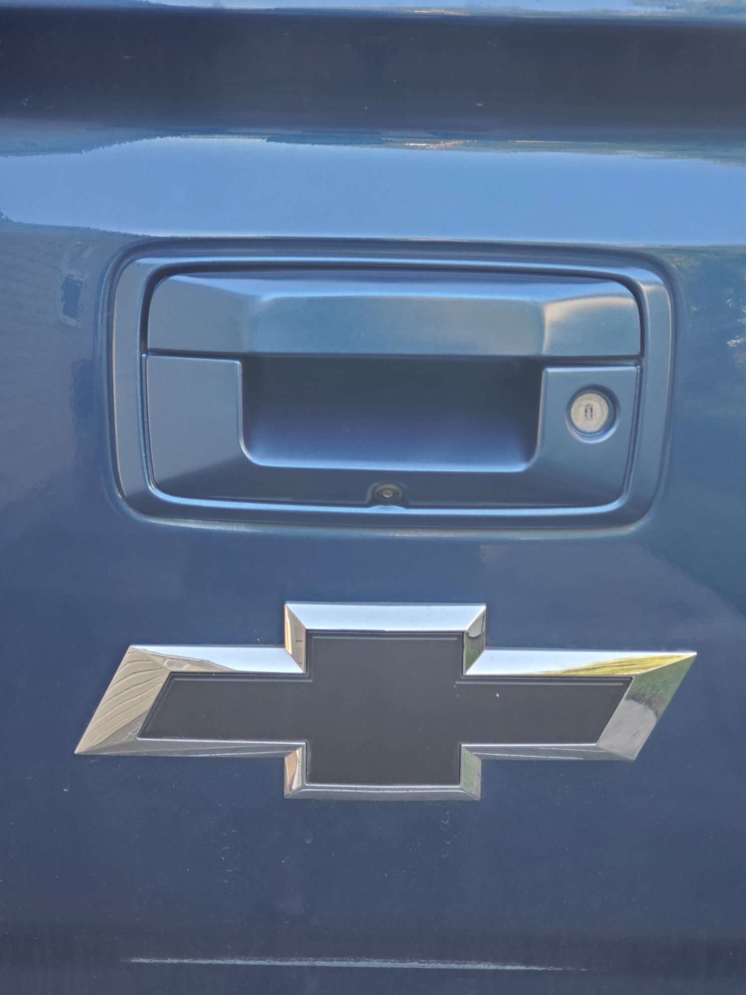

Bought a smoothed out tailgate handle and color matched it myself today, doesn't look too bad for a dirty truck. Lol -

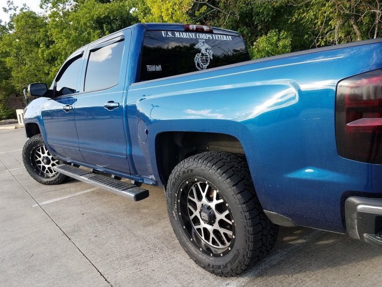

I'm currently running Falken Wildpeak AT3s 305/55/20 which measure out to 33" and the only rubbing I have is at full turn. Other than that, no issues and they ride smooth, no road noise. -

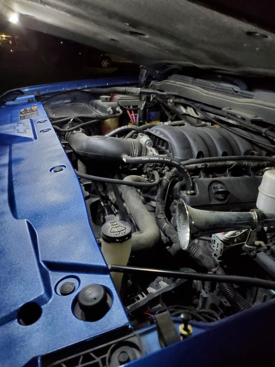

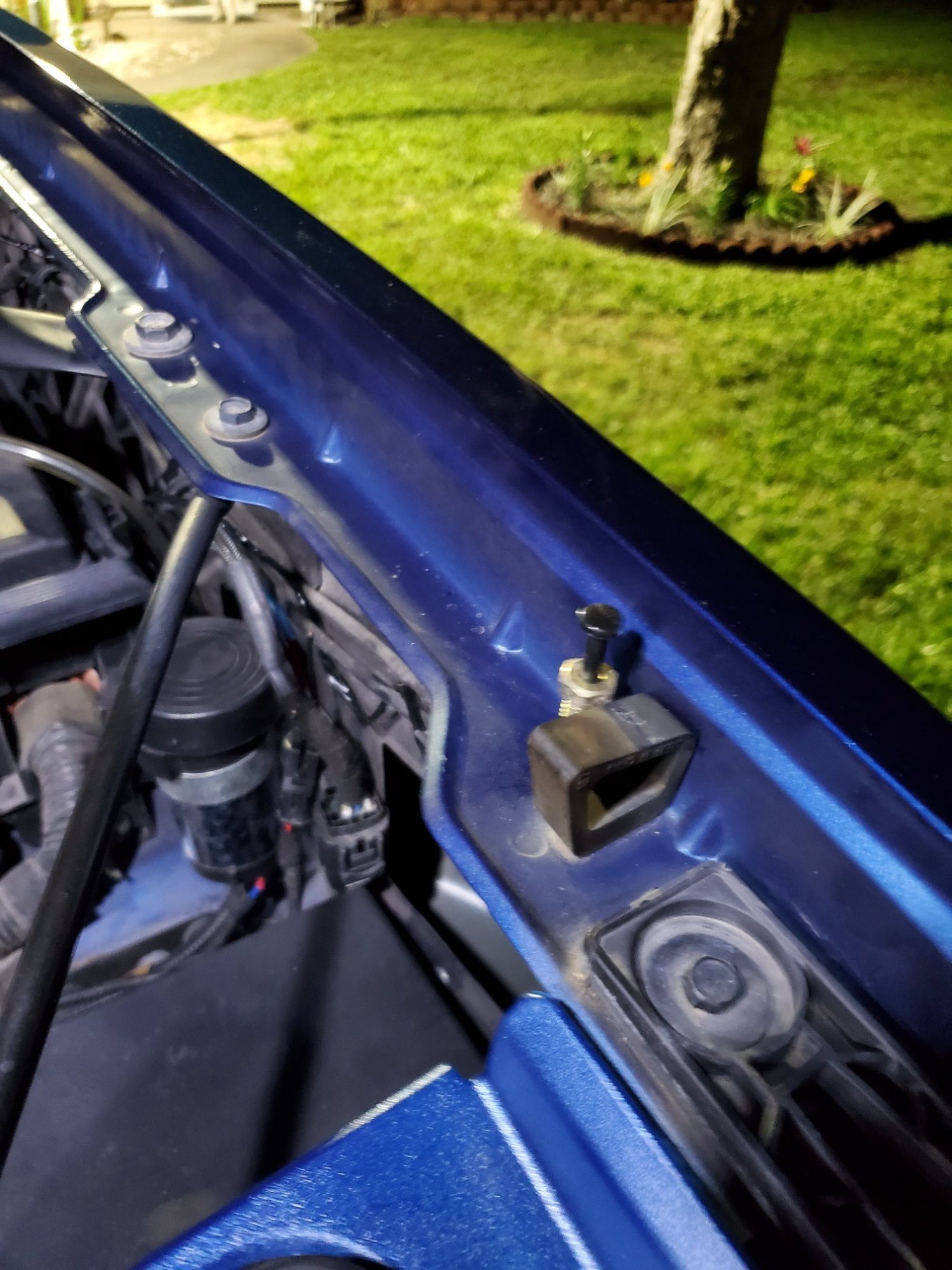

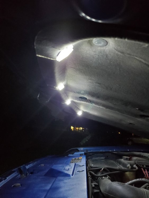

Installed some lights under the hood just in case. Put a hood pin switch so they come on when the hood opens. And the horn in the pic is not hooked up, didn't like the sound of it. -

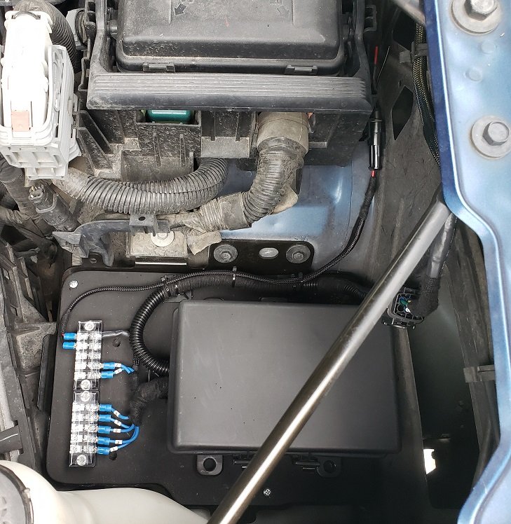

Here's what I did in mine. Fuse box was purchased on Amazon, along with all connectors and accessories. This allows me to add 7 additional accessories, all of which run off their own relay. Accessory wires run to the connection blocks under the hood, which makes it easier, and the switch wires are all already pre-wired inside the cab. I ran those wires through a small grommet just under the door hinge on the driver side, very easy and I didn't have to cut the big rubber grommet on the firewall like some do. Everything is loomed nice and neat to keep it "factory" looking as much as possible. -
The red ones are for thinner gauge wire and the blue ones are for a slightly thicker gauge, there are also yellow ones available that are for even thicker gauge wire. They have their pros and cons just like everything else out there, it just depends on whether or not you want to go back and replace them after a while since they'll be prone to the elements and the small metal inserts can/might rust causing connection issues.
