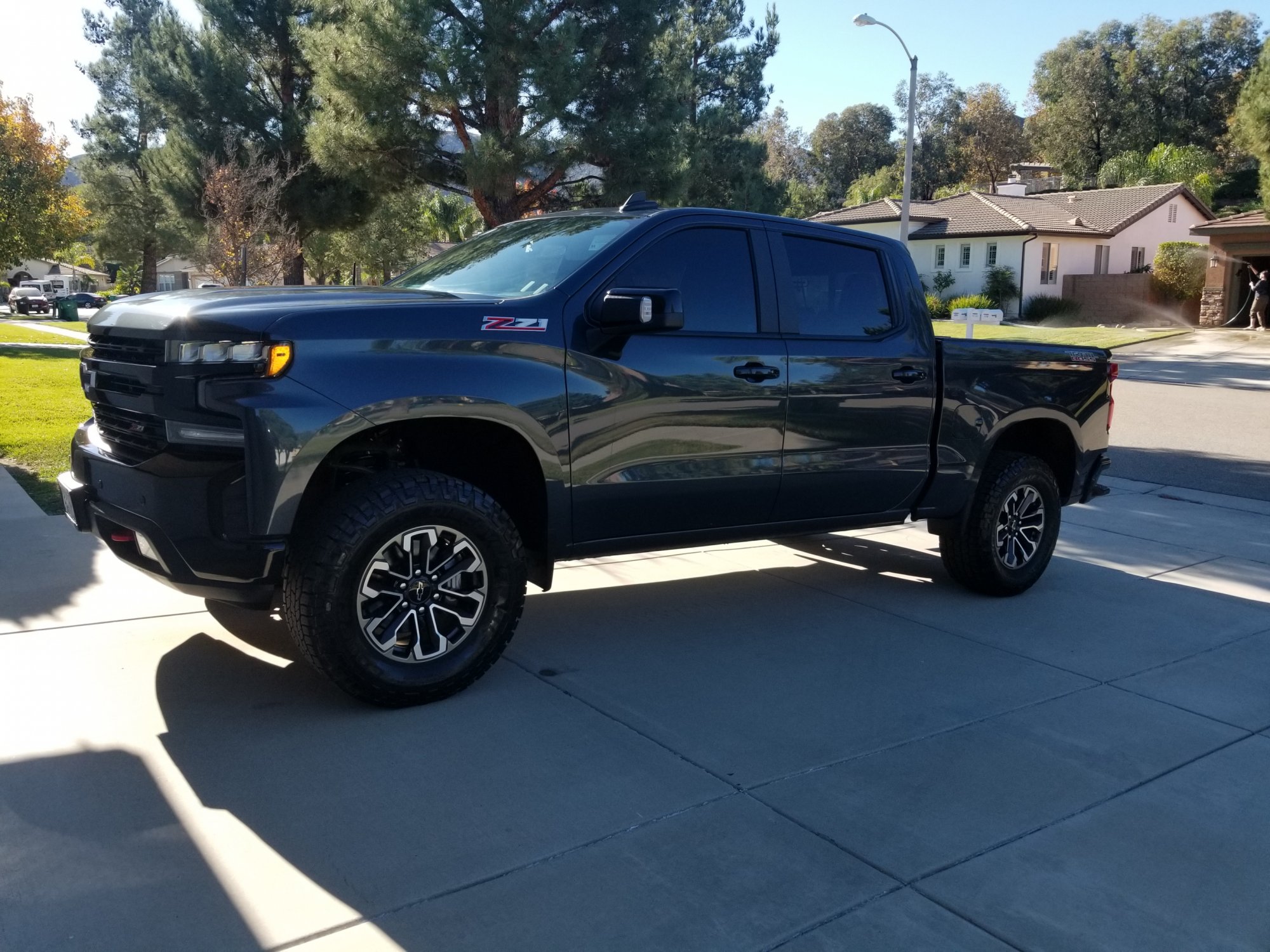

  1. This is set to position 2. Looks pretty good to me. Maybe your At4 is different. I am on my driveway. So it's probably perched a little. I think all trucks sit and rake a little different.
  2. Here's where I got'em. https://www.shockwarehouse.com/site/product.cfm/id/3201223/name/Bilstein-47-309524-Front-B8-6112-Suspension-Kit-Chevrolet-Silverado-1500,-GMC-Sierra-1500
  3. I went with #2 position. It's about a 1/2" lift. Perfect! Don't have to add UCA's or worry about angles. Definitely leveled a bit and feels much more planted. Exactly what I wanted. This is what this truck should come with from the factory.

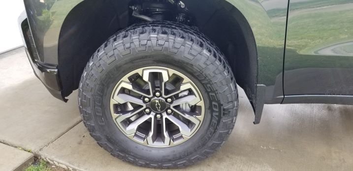

  8. I'm running 305 65 18 Cooper AT3 XLT 33.65 x 12.2. I could have definately fit 34" on this, but didn't want to sacrifice power or travel. I think it's perfect. Feels and sits amazing!

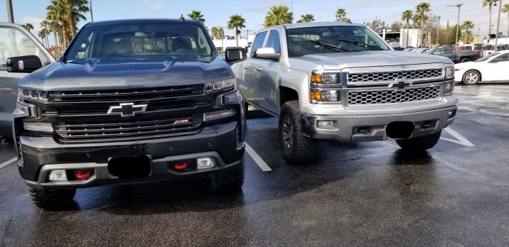

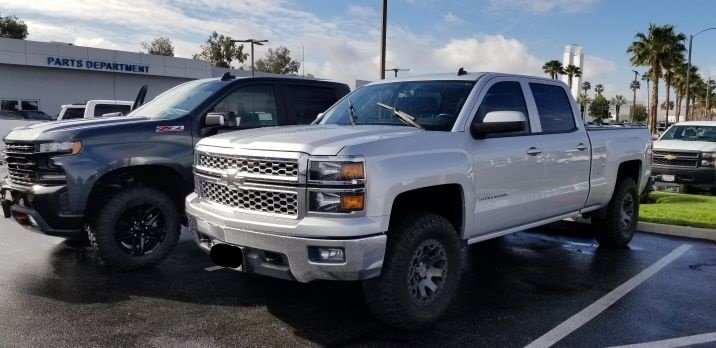

  10. Just Picked up my TrailBoss. Fricken love it!!!!!!!! I immediately put the GM 18" ZR2 wheels on Cooper AT3 XLT 305 65 18. It measures 33.56 x 12.2. Sits and rides so perfect. Could easily put 34" tires, but I liked these. Traded in my 2014 4wd w/Icon shock & A Arm. Loved my 14, but the trailboss has exceeded my expectations!
