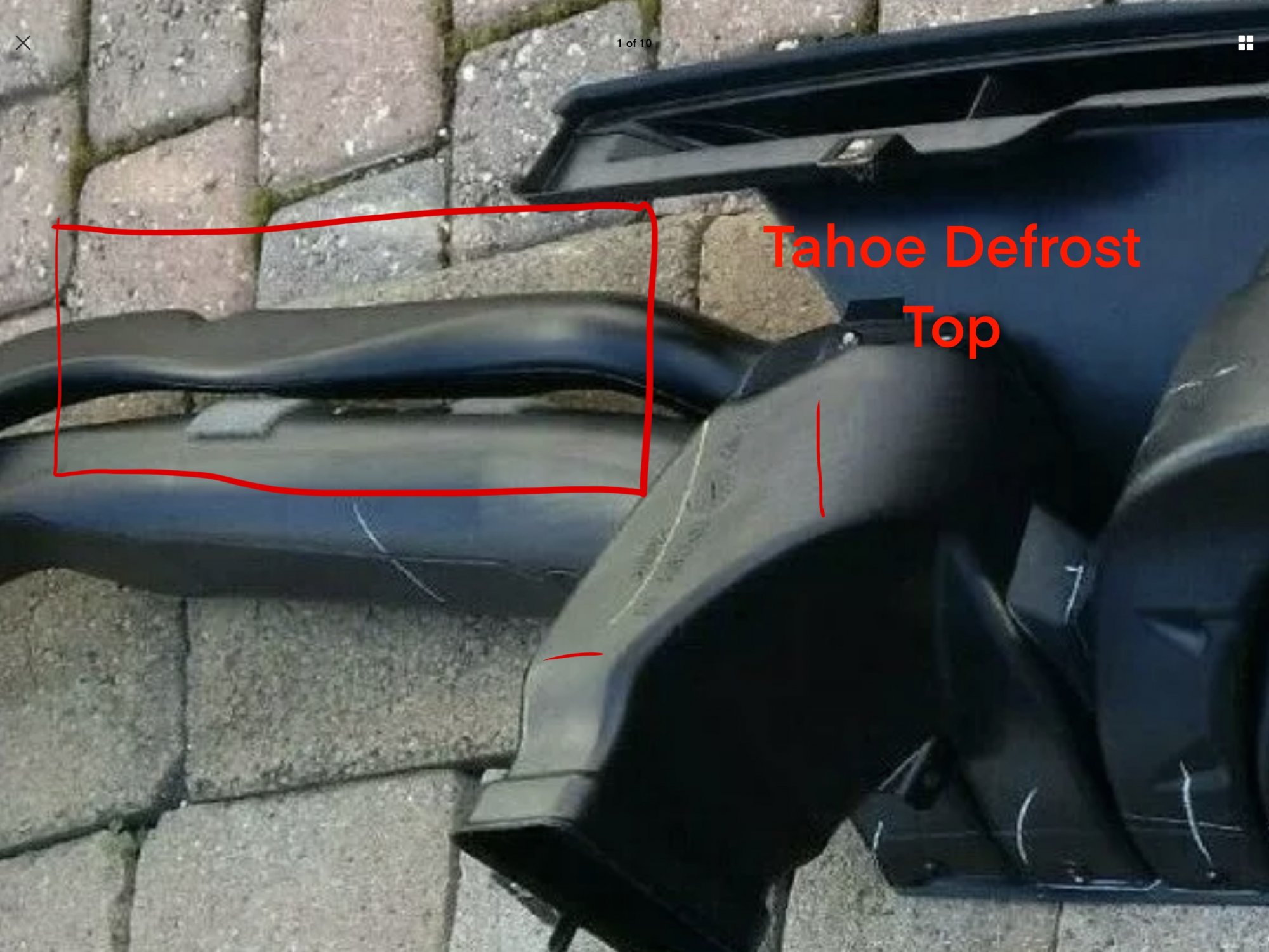

  4. I agree on the tight space. The Tahoe/Yukon tubes pictured seem to be compressed into this space much more than our pickup tubes which seem fairly round. I am going to purchase one of the Tahoe tubes and do some research when I pull this apart to install my HUD. Videos would be great on any install tips. I have followed the adventures on this from the beginning, so I do appreciate all of the attempts. You have really arrived on the cleanest factory appearing solution.
  5. Victor, Thanks for all of your work (and others). I just finished ordering the last of the parts (Trim ring and HUD switch along with wiring harness from HarnessDr.com). A couple of questions: 1. Defroster vent tube - It looks like the Tahoe/Yukon tube is much flatter than the Sierra/Silverado in the middle that would go under the HUD unit. Is it the vertical size that interferes. I know the ends of the tube are different, but I am thinking of trying to build a combo of the pickup ends with the SUV center section. 2. Does the dash pad have to come out or can you remove the speaker tray without removal of the pad and rotate the HUD underneath? I really wanted to avoid taking out the console, but if that is what is needed I will do it. Again thanks for your work, Chip
