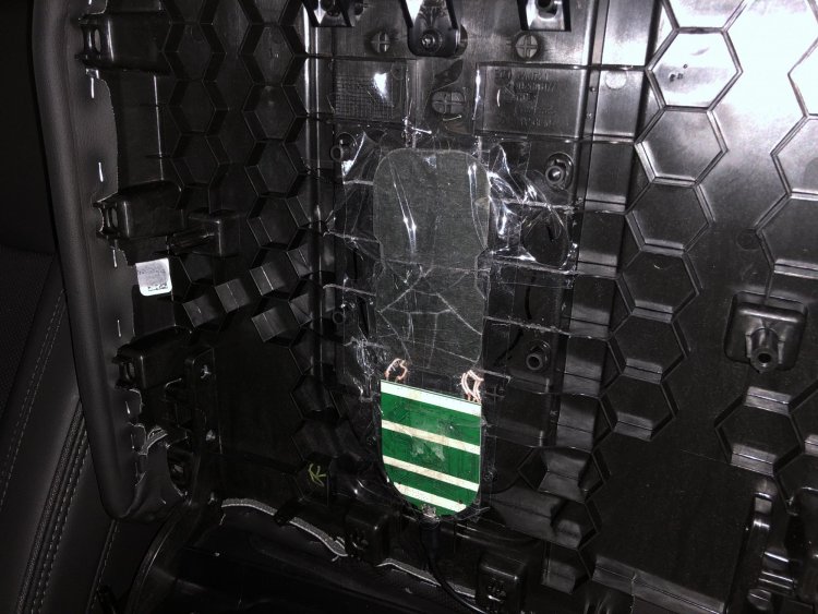

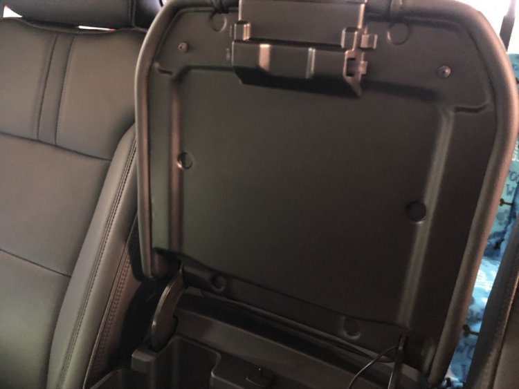

  19. Looks good, The 3 coil is working but I’m glad I didn’t glue it in, because I’m going to switch to this 5 coil version!
