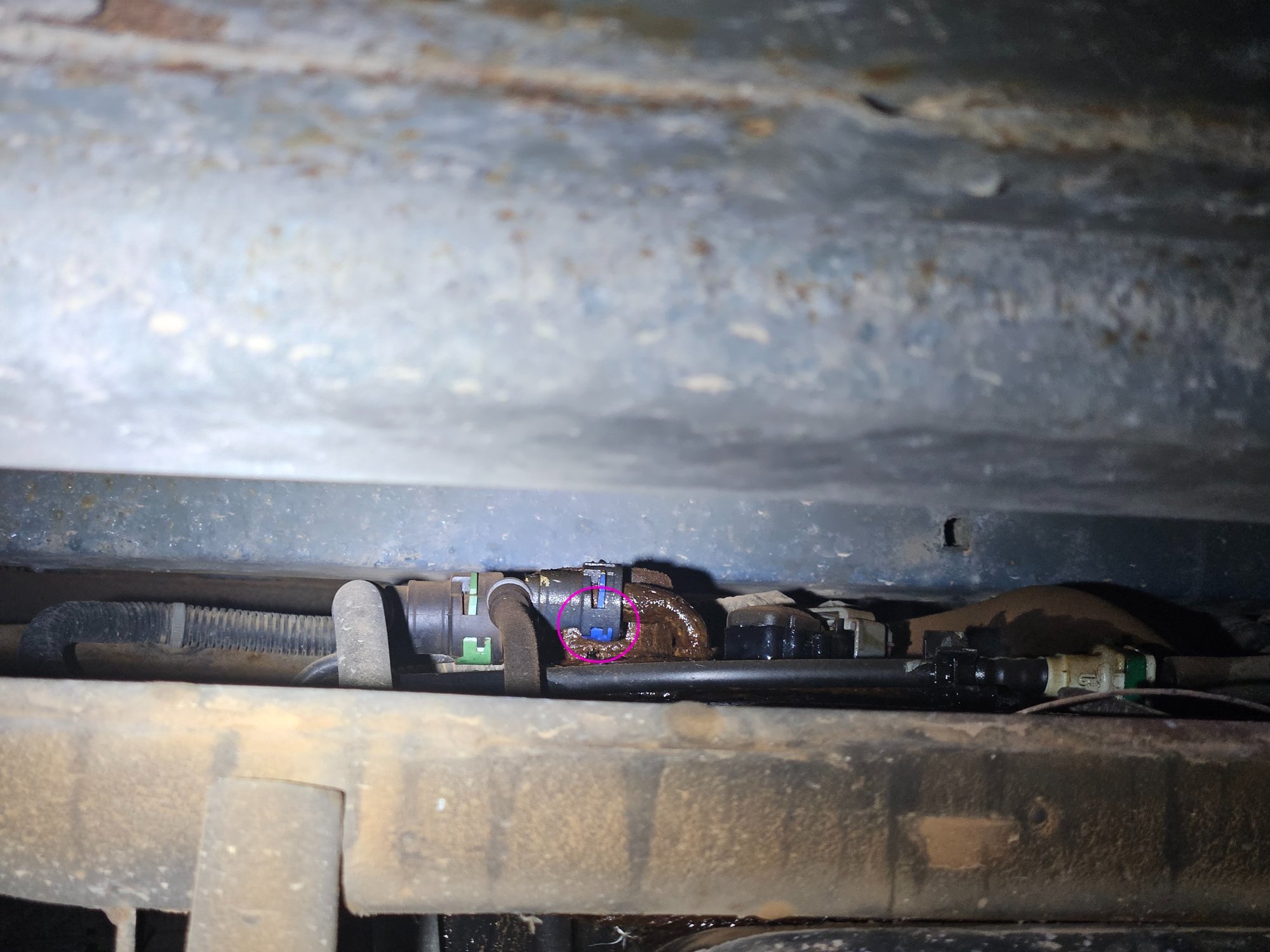

  1. Hi All, Vehicle: 2016 Silverado 1500, 283k miles. I developed a gas leak - it's coming from the top of the tank, appearing to drip from a quick connection while the truck is running. I've attached a photo taken from under the car, bottom of photo is top of gas tank, and am linking a video that shows the drip. Can someone help identify? I'm assuming fuel pump on one side, fuel line (high pressure?) on the other. Any input or troubleshooting steps you could recommend to identify which side is the problem? Would hate to put on a new fuel pump and find I really needed to replace the line, or vice versa. Or, think it's something that would go away if I re-seated the connection? Thanks all, appreciate the advice. -Sean
