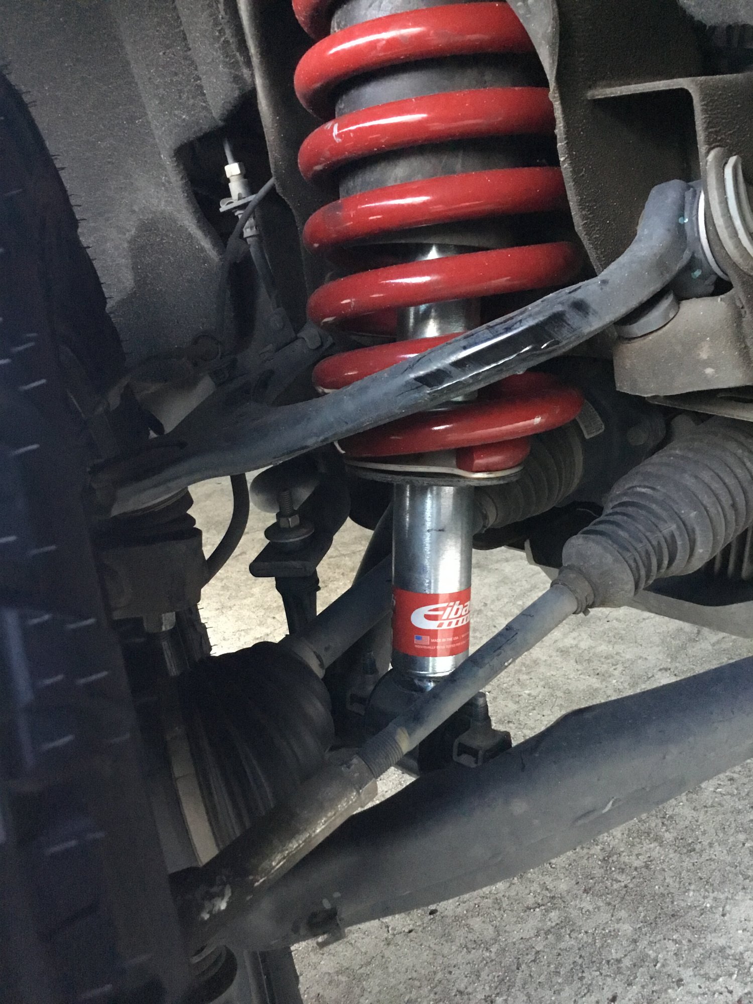

  1. I’d take the springs off...front feels to stiff on bumps...at least I think it’s because of them

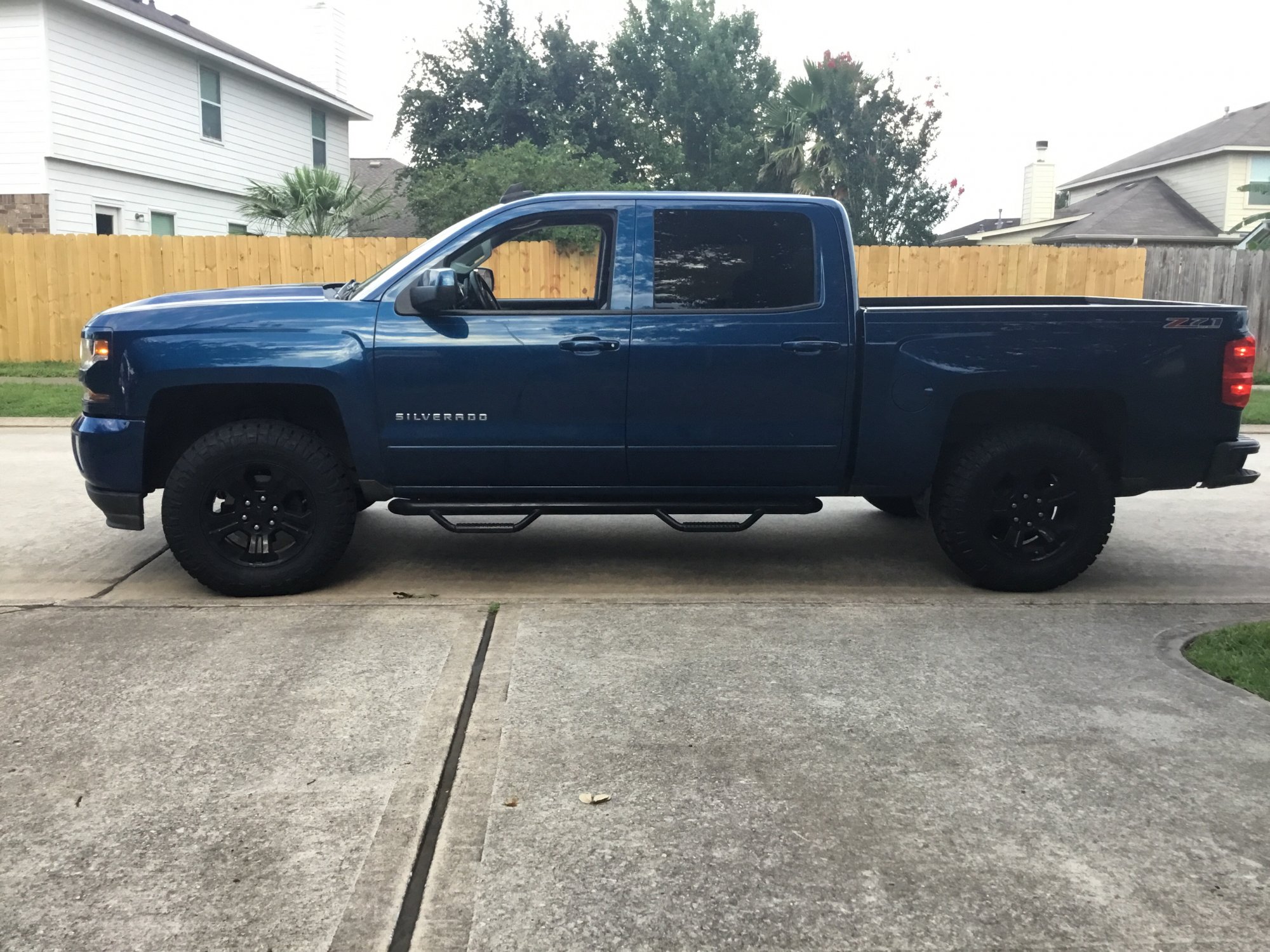

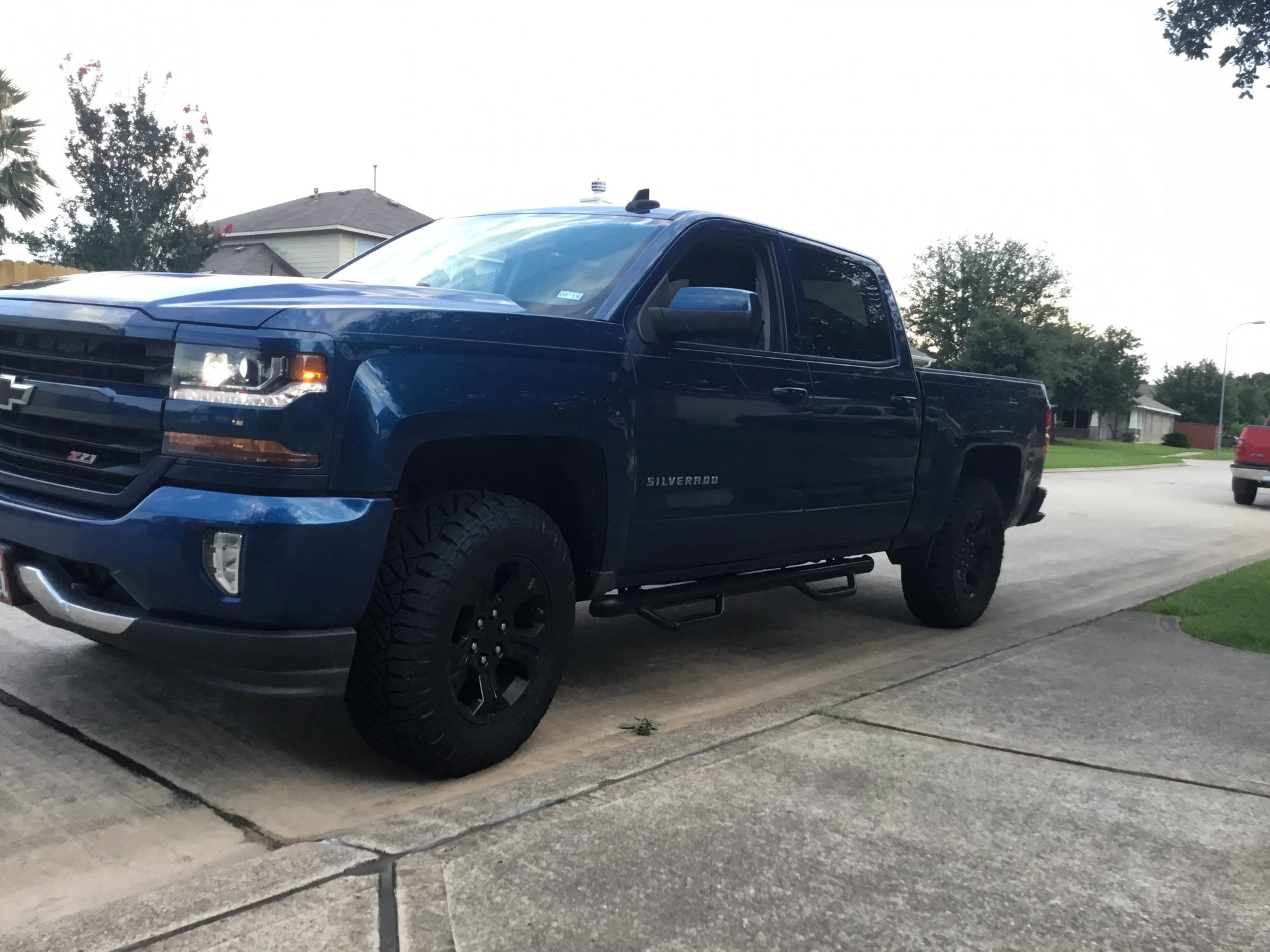

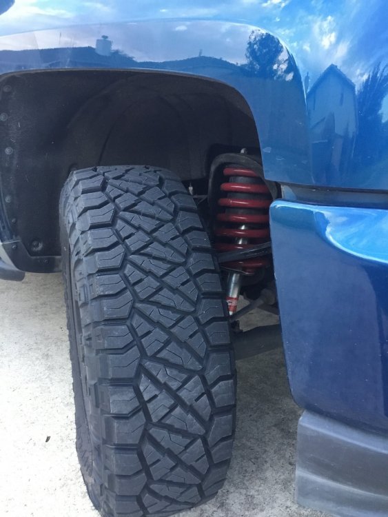

  3. I did a test fit in discount tire with the NITTOs 33/12.5 r18 and welp that didn’t work! ???...when you turn the wheels you will hit UCA (before “full lock”)...I was desperate for tires and they only had 275/70 r18 nittos ridge grapplers. Messuring 33.1 by 10.98.... they look great from the side view but rear or front I’m not to satisfied but I can’t afford new wheels..?
  4. Hey guys just got mine in. can I spray paint the springs, just with some rustoleum spraycan?
  5. Okay thnx.. I will be using stock rims I believe it’s a +24 offset and stock UCA...yeah just to be safe I guess 285/65 will do.
  6. Hello, early next week I should be receiving my eibach kit (2.5” with the springs) for my Silverado 2016. do you guys think I can fit 33x12.5 r18 nitros ridge grapplers or just stay at the 285/65 ?
