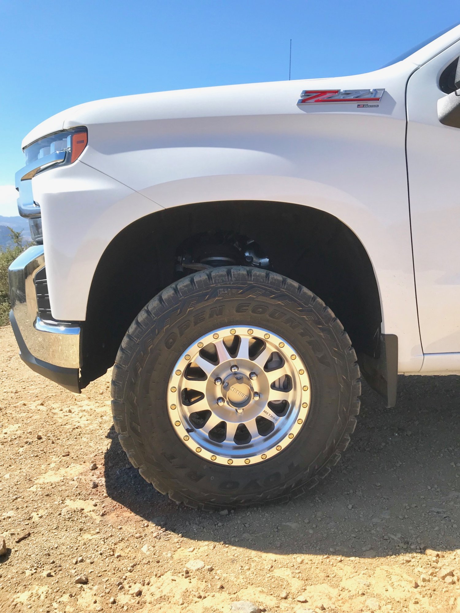

Next, it was time to get some real hikin shoes on her. In anticipation for the new suspension requiring wheels with a minimum of 4.75". I ended up finding a set of 5 bran new Method Double Standards with Toyo Open Country R/T tires mounted for a killer deal on the http://www.race-dezert.com Classifieds section. In the end I had to add 1/2" wheel spacers on the front wheels since the wheel just barely contacted the brake caliper and 1/2" spacers were the smallest I could find. Breaks my heart to have to use wheel spacers but....what're ya gonna do? Wheels: Method 304 Double Standard (machine finish) 17x8.5 Tires: Toyo Open Country R/T 285/70/17- 79 replies

The "spokes" as I will refer to them, contacted the side of the caliper. I know 4.75" backspacing (which is what these have) clears on other wheels but apparently not the Method Double Standard wheel. Breaks my heart having to use a spacer but, eh, it's only 1/2". -

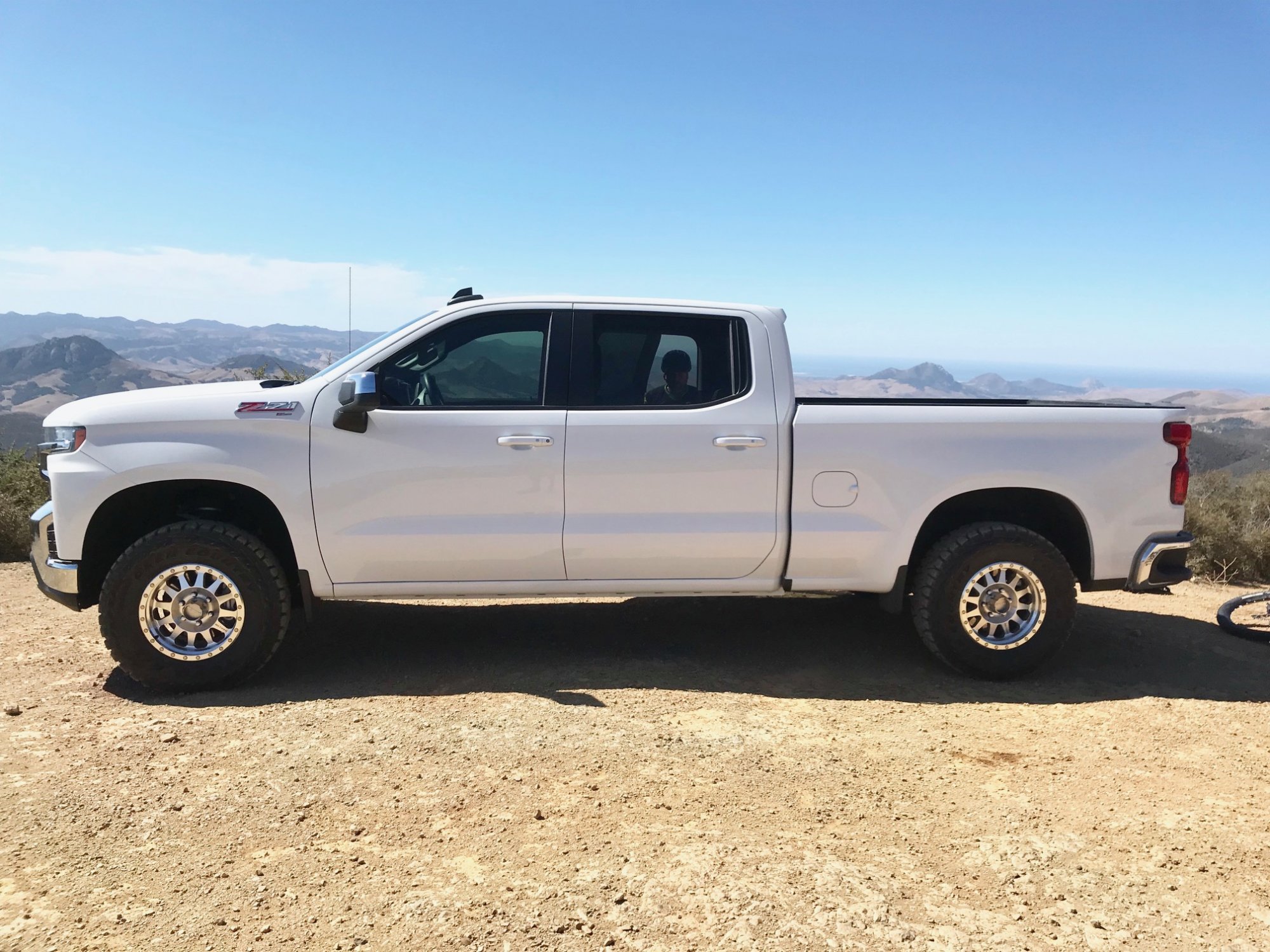

Waited and searched for this truck. Crew cab with a real 6.5' bed. Not the stubby 5.5' bed that most are coming with nowadays. Window Tint: 50% with 8" strip across top of windshield Lift: Motofab 3" leveling strut spacer Exhaust: MBRP 2.5" cat-back exhaust. I went with a system because it retained the factory tubing diameter in hopes of gaining a 'mature' sounding exhaust but man was that a mistake. For some reason this MBRP system DROOOONES! Like, BAD!. It sounds like a 16 year old kid just found his fathers hacksaw and went to town on his exhaust pipe. I will most definitely be swapping it out for another system once I hear some real-world examples. Wheels: 17 x 8.5 Method Double Standard rims with 285/70/17 Toyo Open Country RT tires. The wheels did contact the front brake caliper just a hair so I had to add 1/4" wheel spacers to achieve proper clearance. I would definitely go with a 35" tire next time though, I just got a SUPER killer deal on 5 of these wheels. Styling: USA Flag tailgate letters look pretty slick! Next up: Fox suspension on all 4 corners, Camburg Racing upper control arms, Deaver leaf pack and Baja Designs 30" light bar. -
