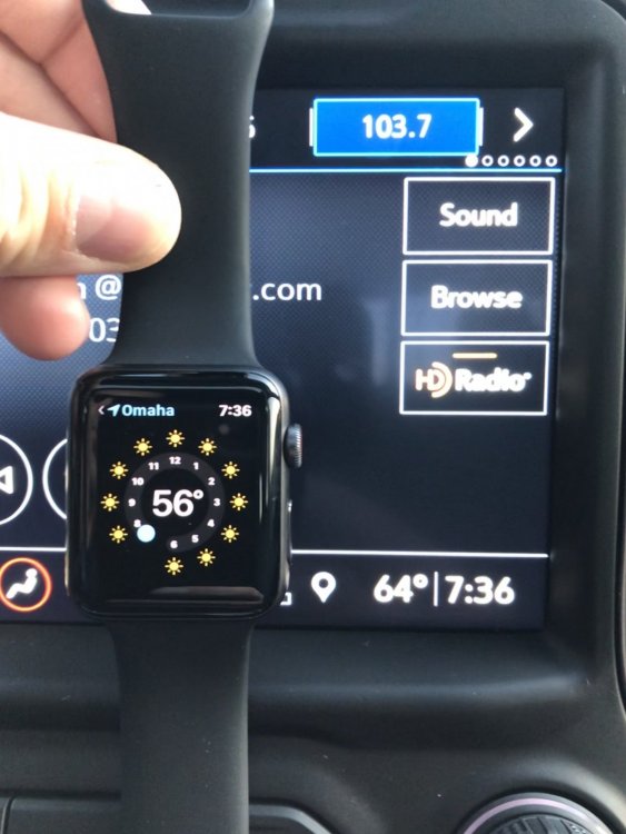

  5. 2019 Silverado Trail Boss LT Z71: 9,500 miles My ambient air temperature reading on the infotainment system has always been about 7 - 10 degrees higher than what the actual temperature is. I have taken it into the dealer 2 times. The first time, they "Said" they tested it and it looked normal. I doubt they tested anything as it was just one of the items on a list of about 5 other things they were doing with my truck. I took a pic of the temp on my phone/watch next to the infotainment temp and it showed an 8 degree difference. They said to keep an eye out for updates to the system.. Ugh. I took it in again about 2 weeks ago and a different dealer replaced the sensor. Apparently it is in the passenger side mirror? Anyway, that did not fix the issue. It is still not accurate! I read another post on a different site and it said to try an instant update by: To perform an instant update of the Ambient Temperature Sensor, simultaneously press and hold the Re-circulation button and A/C button on the HVAC control head. I am going to try this over lunch - i'll update my post soon. Anyone else have this issue?
