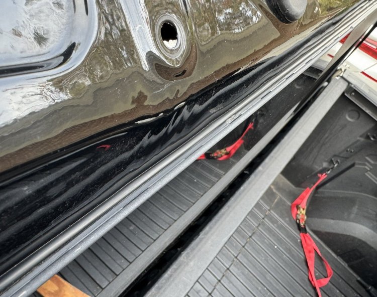

Here's a pic after applying the seam sealer. The sealer was glossy black. Blue painters tape was used to prevent any spillover onto the outside of the rear glass. Also, notice the circular rings of 3M windshield butyl tape I place around every bolt hole for the spoiler. I didn't trust the original foam washers that were deformed under compression when the spoiler was bolted from the factory. If you are not aware already, this is a common problem that many have already posted about on this forum. -

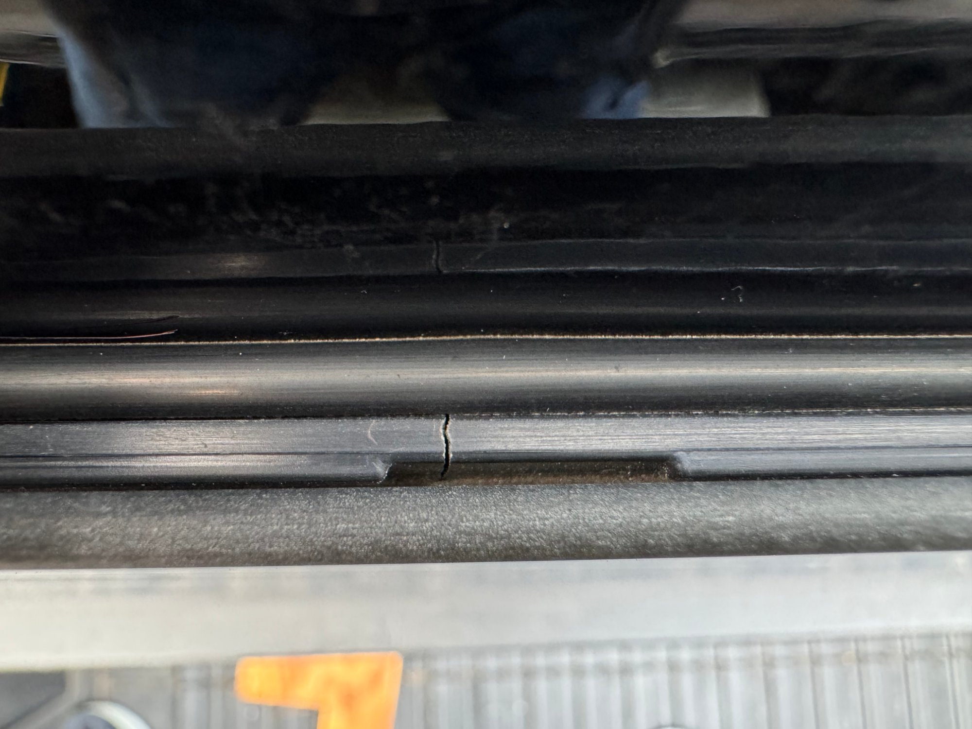

Here's one of two fractures I found on the brittle plastic frame at the top edge of the rear glass. Repaired it back in December with a tube of 3M Urethane Seam Sealer, 08367, Black Color and it never leaked again. Just run a bead of this self leveling sealer alone the entire length of the plastic frame so water will never settle in the channel. -

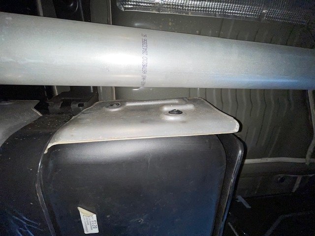

For those who are still having this heat shield noise issue, I wanted to let you know that I have not had the noise for the last couple months so I believe it is now resolved on my vehicle.- 1 reply

As with many of us, this buzzing vibration noise has been eluding me for months. It sounds like a heat shield or thin metallic sound just as some of you have described. I typically only hear it randomly at very low speeds and rpm such as when I am turning into a parking space or reversing slowly. I'm certain it still happens at higher speeds but I don't really notice it because of wind/road noise or the music being turned up. I've seen the other posts mentioning the heat shield at the spare tire and leaf springs but this was not my case. I went back under the my 2020 Sierra today and combed over it inch by inch, plucking and hammering around. The heat shield at my spare tire seemed fine and didn't have any clearance issues with my GM performance exhaust pipes. I made it up to the fuel tank and finally replicated the buzzing sound when I hit the plastic tank. I discovered the buzzing vibration sound was coming from the fuel tank heat shield on the driveshaft side. I reached up to the top of the heat shield and bent it at the top slightly away from the tank and the noise is gone whenever I hit the tank. I initially flexed it too far and popped out one of the plastic retainer clips. It was easy to reseat the clip. I haven't been able to replicate the noise for now but only time will tell. Listen to the video clip to determine if your noise is similar. I have not come across a post about the fuel tank heat shield yet so I hope this helps some of you out. buzz.mp4

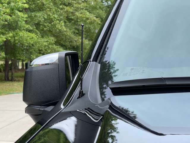

I have a Sierra 1500. I initially tried the popular aftermarket rubberized stubby you find on Amazon. It performed fine and required a thread adapter which was included. I only kept it on for a few months because it got tired of noticing it all the time. Although it was short, the thickness of it stood out to me. Just about all of my front seat passengers would ask, "Was that always there?", referring to the "covert-stealthy stubby antenna. I ended up replacing it with a shorter version of the factory antenna. It is 7 inches tall and does not require a thread adapter. Looks stock but a lot shorter. Performance of this antenna seems to be the same as the stock one. All the same stations come in fine. I found it at theantennasource.com. Free shipping was quicker than I expected. https://www.theantennasource.com/GMC/SIERRAPICKUP/Sierra2020-1500.html#1A They also have 9, 12, 15, 21, 24 and 27 inch versions in black. Other sizes come in stainless. -
