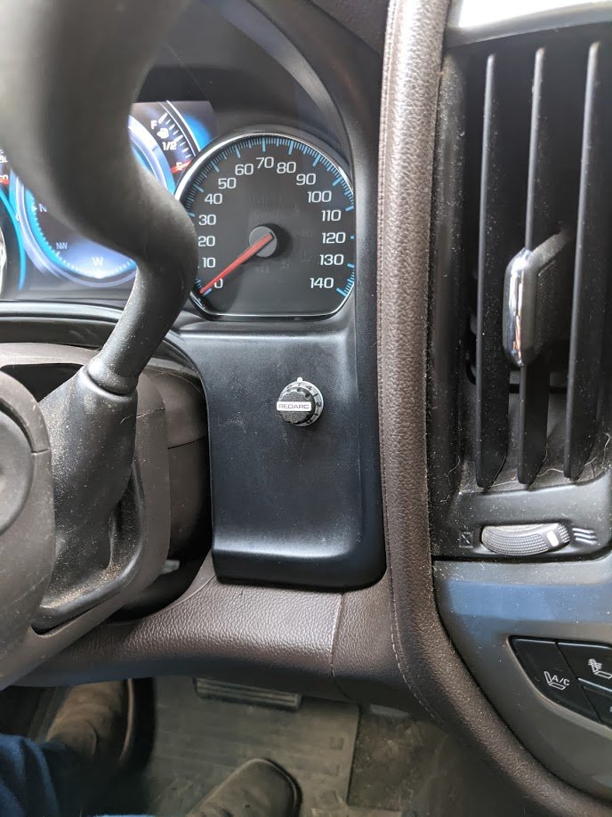

I'm assuming you can't see my picture so I just edited my original post to change how the image is attached. Let me know if that works for you. -
Adding GM factory trailer brake controller
truckmann replied to McClain210's topic in Modifications & Accessories
I know this is kind of old, but I just added a Redarc to my 2014 and figured I'd share my control mounting location since I've not seen anyone else put it where I did and yes I know my truck is filthy right now. -

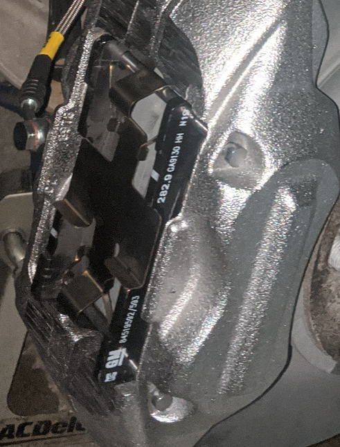

Here is what I ordered from Rock Auto and I got some Stop Tech SS brake lines number 950.66002 from ebay. The brake lines aren't really needed, but I figured since I was in there I may as well upgrade those too. The price of the brake pads was stupid, but they also came with a new pad life sensor which I didn't need. I'd bet you will be able to find pads cheaper before too long. -
19 SILVERADO FRONT BRAKE UPGRADE
truckmann replied to ModJunky's topic in Modifications & Accessories
I got the new brakes installed last weekend. Everything went as expected making it a pretty easy swap. My stock wheels would not have cleared if I didn't have the spacers. They were on my truck when I bought it and don't seem to be hurting anything so I've just left them. They do seem to have better stopping power than the old setup and the pad install on this type of caliper is super easy. The pedal feel is a little better, but not as firm as I hoped it would get to. I could probably use a better flush of the old fluid though. I may try to do that later on. I have a Motive pressure bleeder, but even using that the fluid was very slow to get pushed through the lines. -
