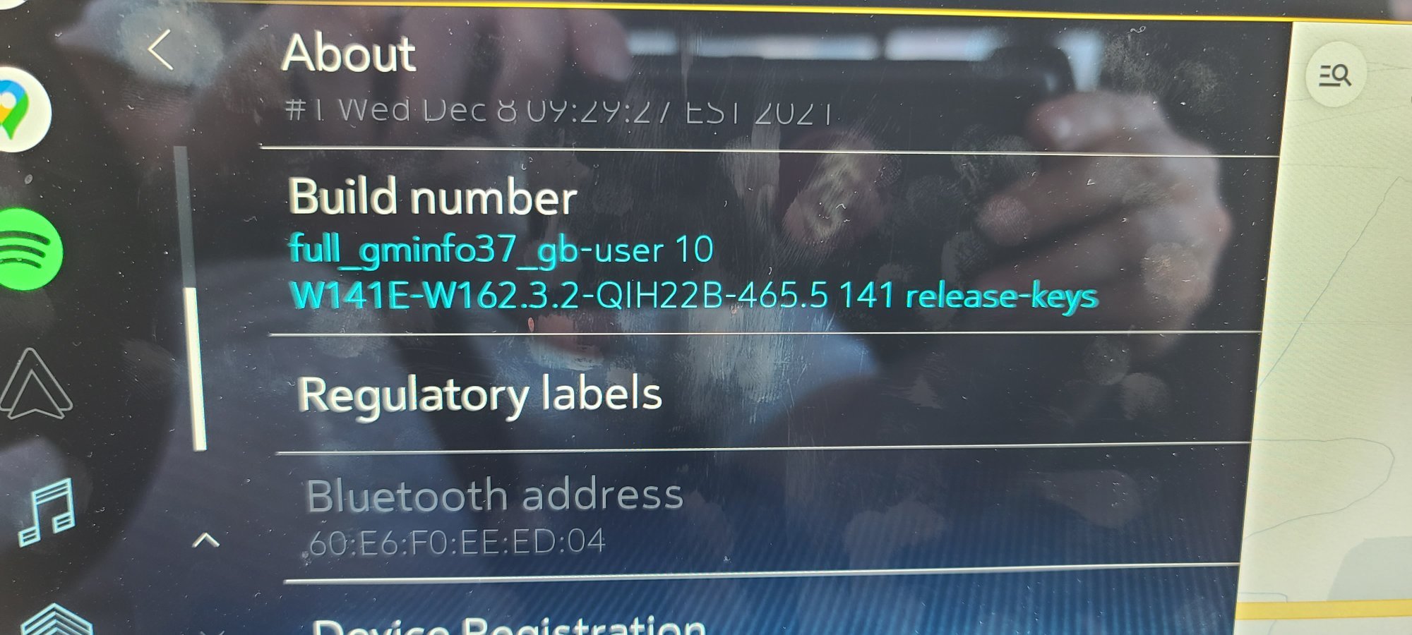

  9. Apparently mine did not update to the latest version. I did get an update but our versions differ.
  10. Vehicle off, drivers door open for 5 minutes. Supposed to be the "reset". OnStar had me do this when I contacted them for some troubleshooting.
