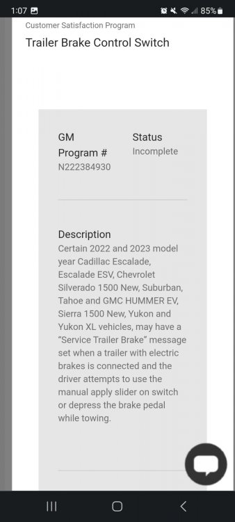

  1. I received the same letter today. I need to go back into my email to see, but I believe they called this a "recall" in that update email I received last month. What perplexes me about this is why not call it a recall? Doing the calculus in my head, It's a $30 part and takes maybe an hour or so of service to replace? I feel as if most truck buyers who have this package will not tow, however these trucks will enter the secondary market where it's acquired by someone who might want to tow. I keep going back to this being a safety issue and the (my perceived) low-cost of repair, they should handle this in perpetuity if it's never been resolved by the original owner... But that's just my $0.02 - I work in customer experience, this is just a horrible one and does not reflect well on the GM brand. I am getting close to 33mpg on my 4x4 3.0 LM2 between Pittsburgh and Columbus when I need to commute, so I'm not looking to trade-in/switch just yet. Camping season just getting ready to start, I'm curious to the mpg and DEF consumption while towing this spring (just did 2 short tows last fall) - I imagine it still beating out the gasoline options in the long run form a value-perspective.

  3. All stop. The recall looks to be issued today. Check your diagnostic report/call your dealer. I got this in my monthly onstar diagnostics email today... I'm wondering if I need to tell my service manager to clear mine because it wad fixed the first week of January...
  4. The service manager replied to me this am. He gave me part number 84488395. This looks like a legacy part number upon web search. I wonder if there was a bad batch or something...

  6. Ok. Was able to test this afternoon. Good news. No brake controller errors, gain was fully adjustable and the toggle was responsive each squeeze. I didn't feel weight while pressing the brake pedal either when testing. I've attached the details of the work order bur it does lot look as if a part number is on it. Please let me know if you have any questions! -Brent

  12. Mine is. The service bulletin also states '23 in some cases Brand: Model: Model Year: VIN: Engine: Transmission: from to from to Cadillac Escalade Models 2022 6/10/2022 EOP All All Chevrolet Silverado 1500 New (RPO J22, VIN Digit 5 = A or D) 2022-2023 11th VIN Digit Z: 7/12/2022, G: 6/30/2022, or 1: 6/27/2022 9/29/2022 All All Chevrolet Suburban 2022 6/10/2022 EOP All All Chevrolet Tahoe 2022-2023 6/10/2022 EOP All All GMC Sierra 1500 New (RPO J22, VIN Digit 5 = H or U) 2022-2023 11th VIN Digit Z: 7/12/2022, G: 6/30/2022, 6/27/2022 or 1: 9/29/2022 All All GMC Yukon Models 2022 6/10/2022 EOP All All
