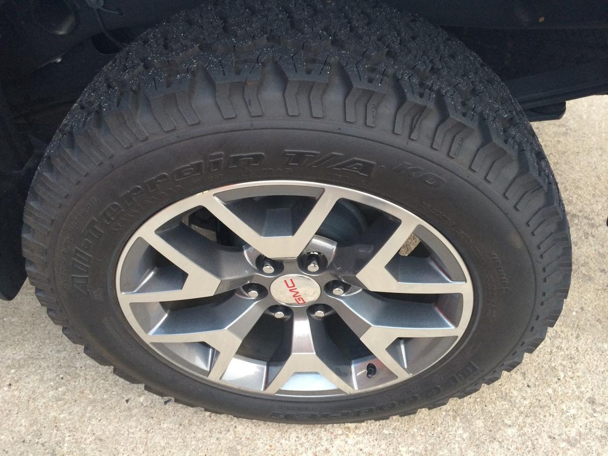

  5. They are factory rims. Once the Michelins were put on it drives very smooth with no vibration.

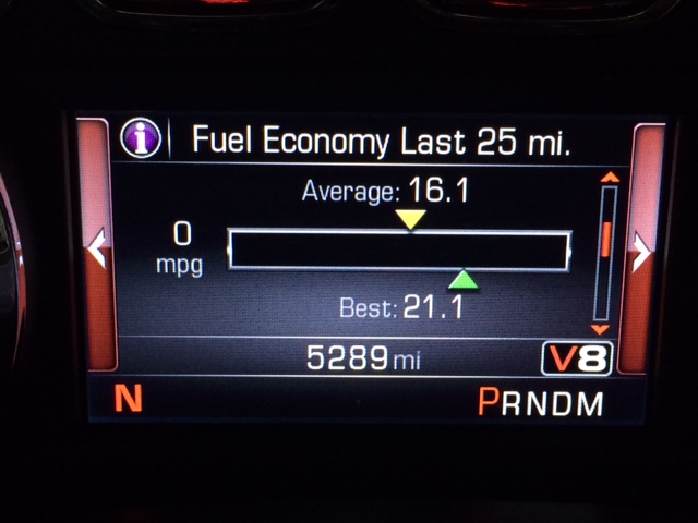

  6. 2014 GMC AT 5.3 3.42 4X4 I had a problem with vibration and recently changed tires from BFG 285/55/R20 to Michelin LTX 275/55/R20. I also removed air dam, then reinstalled. Before I was only getting avg of 13 MPG. I also just had the recall done. Now I am at

  9. I know, but I was tired of dealing with both the dealer and the tire shop. They are next door to each other and have a relationship. They wouldn't admit they might be defective, and the dealer also said they balanced within spec (backing them up). Kept telling me it was because they were an LT tire. I kept telling them stiffness had nothing to do with the bad vibration. I'm just glad it was only the tires causing my problem. I can enjoy driving my truck now. The only time I use my 4X4 is on the beachfront in the Summertime chasing the speckled trout.
  10. Ok, I got the Michelin LTX M/S installed this morning and my truck now rides like a Cadillac. It cost me some $$ though. My story is different than most. My dealer had the shop next door install BFG AT 285/55/R20 10 ply before I took delivery (charged me $800 with trade for SRA's). Mine would vibrate the passenger seat badly at 70-80mph. When I took the truck to the dealer for vibration (fire recall & clunk in rear end) they rebalanced (road force) the BFG's again, and said they were within spec. I still had same vibration. I took it back to the tire store and paid $324 additional for the LTX's. The truck doesn't look as good with the 275/55/R20, but I would do anything to get rid of the vibration.
