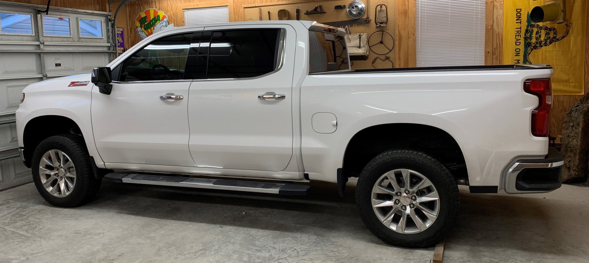

  8. The final product... not the best picture but at least it's clean!

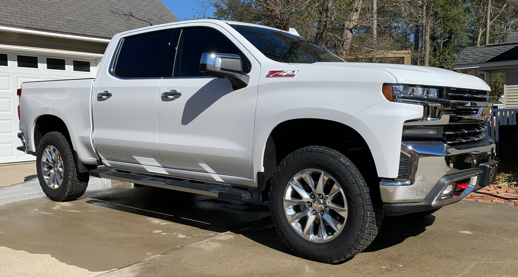

  13. After ~8 hrs, I got the RC lift on (working by myself). It wasn't a bad process though disassembly and reassembly of the struts almost made me throw in the towel (thanks goodness for pneumatic tools to tighten the compression tools). I ended up with 3.5" in the front and 2.5" in the rear which leveled the truck at 41.5" on all four corners... very happy with the outcome. Now all I am debating is what size tire to go with (leaning towards the Nitto Ridge Grappler in 35x11.50) and whether to keep stock wheels or take the plunge and order a set of Fuel Rebels in bronze. If you have a similar setup, post some pics up of Nitto Ridge Grapplers with stock or aftermarket wheels with details of offset, etc.

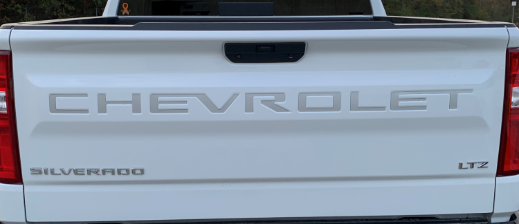

  21. I ordered my letters (BD Trims) from Amazon and got them in 2 days.... gotta love Prime. Sent from my iPhone using Tapatalk
  22. BD Trims silver inserts on white.... wanted something subtle, very pleased with their product and the way it turned out.
