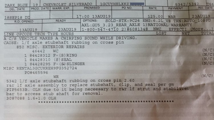

  1. I just picked up my High Country from having bulletin PIP5653B Jingle Jingle "fix" completed. Now it's a wait and see if it returns.
  2. Can you pm me your dealers name and service writer's phone number and your work order number? Mine is scheduled for the jingle fix on Friday and I'll tell them it didn't fix yours, I'd like to give them the name and phone number in case they'd like to call them. I'd rather not have them do it if it doesn't fix it.
  3. I'm going on 3 months with mine being resealed. Been through touchless car wash a few times, and many hand washes, and I shoot jet of water into all the cracks around the 3rd brake light every time I wash it...So far no more leaking.
  4. I stopped in today and talked to Mark, my service writer, and gave him the PIP5653A/B bulletin number and he looked it up and it had the part numbers to fix it. He ordered the parts and he'll contact me when they get them in and schedule my pickup in for the repair. I don't have a list of what parts are needed for the repair, but they did mention one being an Axle Shaft.
  5. Do you have the bulletin number or some "key words" ie, jingle, clang, etc, that will assist my service writer in finding this bulletin?
