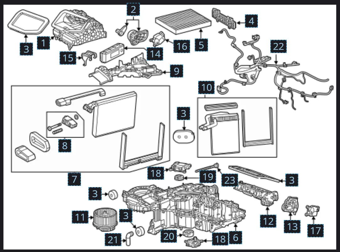

  3. So I did the battery and fuse procedure and it seemed to work for a few days, but now I have the same issue again. I've been told by multiple people and my own research that one of the blend door servo's needs to be replaced. There are 3 blend door servo's Part's 16,17,18 on this diagram, Does anyone know which one controls the driver and passender dual zone climate? Youtube video seems to point to Part number 18 right near the glove compartment. I just wanted to do a little research before I start replacing parts.
