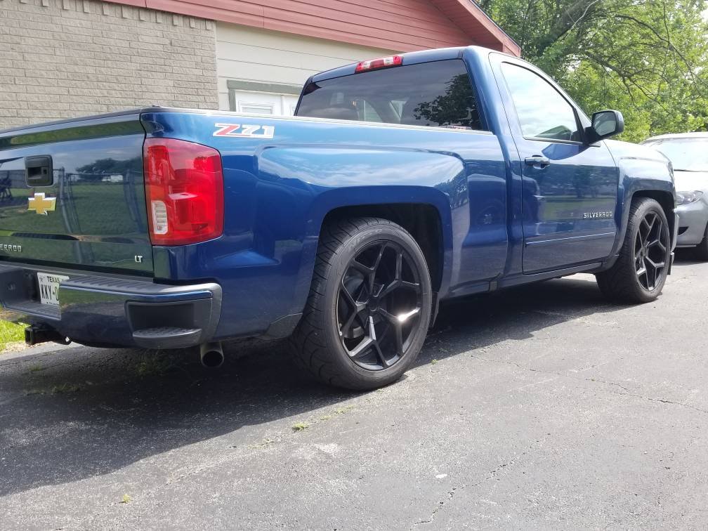

  7. Yes, MRR T228. 22x10 That blue truck looks more like Lovelessjl's truck. LOL maybe he'll post the pic from that angle.

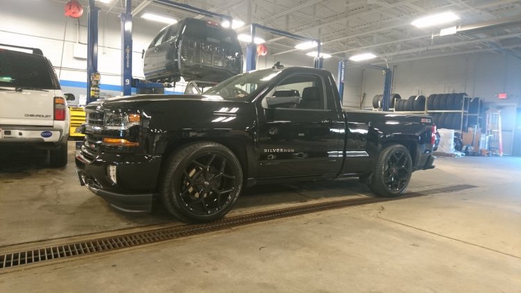

  9. Thanks, man! yes, I did replace the upper control arm bushings to get my camber in spec. It was a huge pain in the ass to press the old ones out, even with the tools that Belltech supplied.
  10. If you're using all Belltech stuff I would leave the shocks at 2'' if you are going to go 6'' in the rear. I'm only 3/4'' higher in the rear with shocks at 2'' and 2'' spindles in the front. I even took the last 10mm ring out of the right side to level on the front side to side since my right side was 3/8'' higher than the left. he last 10mm only dropped it down the 3/8 to even it out. so you might risk being a little lower in the rear if you set the shocks to 1''. Look at my pictures and decide for yourself.

  12. 2800 miles. took the 10mm ring out of the right side shock and it got rid of the lean and both sides are the same height now. Also dropped the rear down to 6, so altogether I am pretty much 4/6 now. Installed offset upper control arm bushings and set my alignment. Did my second warranty oil change too since I had the truck in the shop.

  18. Well the right side was dead nuts on but the best I could get the left side was -0.5 so I adjusted the right side accordingly. My caster is wicked high but like I said, that's not necessarily a bad thing. Truck rides nice and drives straight, I think I'm done messing with the suspension. On to the next project.
  19. I'm rocking the stock wheels again until I get this all sorted out since I don't want to risk chipping the 22s with the alignment heads. Here's what my specs look like with just the toe set for now and the set up for pressing the bushings out
