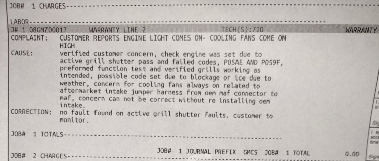

  12. So I've officially had this happen for a 4th time now except this time I used the block heater. Temps went down to - 30c overnight so I plugged it in. Following day fans were on 100%. Made an appointment with the dealer and just got it back this evening. I put the s&b intake on between the 3rd and 4th cooling fan issue and now the dealer is trying to blame the issue on the maf sensor extension harness with the s&b kit. I think I need a new dealer or gm is just a joke it's been 2 years with this issue and still no fix
