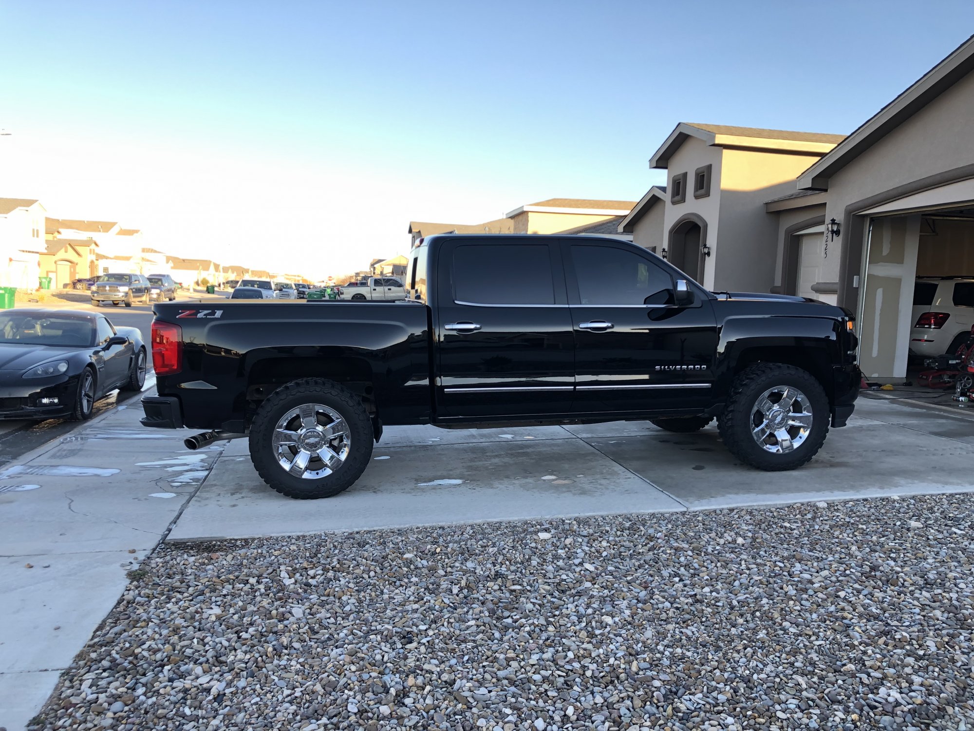

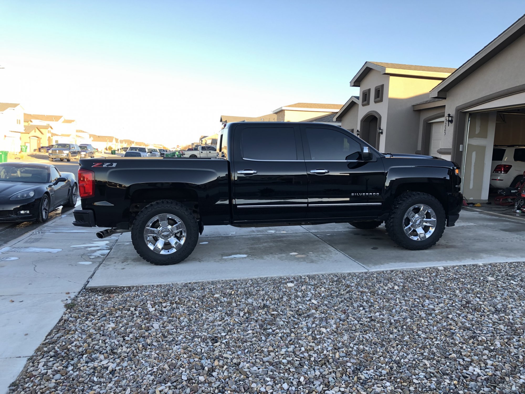

  1. Yea definitely, the tire size ends up being about 34” tall and 11.6” wide. I did a full NorCal mod and the rubbing is now gone.
  2. 2018 LTZ Z71 w/ 2.25” ReadyLift Kit (only used top spacers because of the Rancho shocks). Tires are 295/60/20 Toyo MT’s.
  3. With the stock tires, no rubbing at all. With the tires I went with, 295/60/20, definitely rubbed, but I did the full NorCal mod and no more rubbing.
  4. Finally got around to posting mine up
