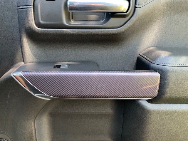

  4. Looks really good. Got any closeups of the inlays installed?

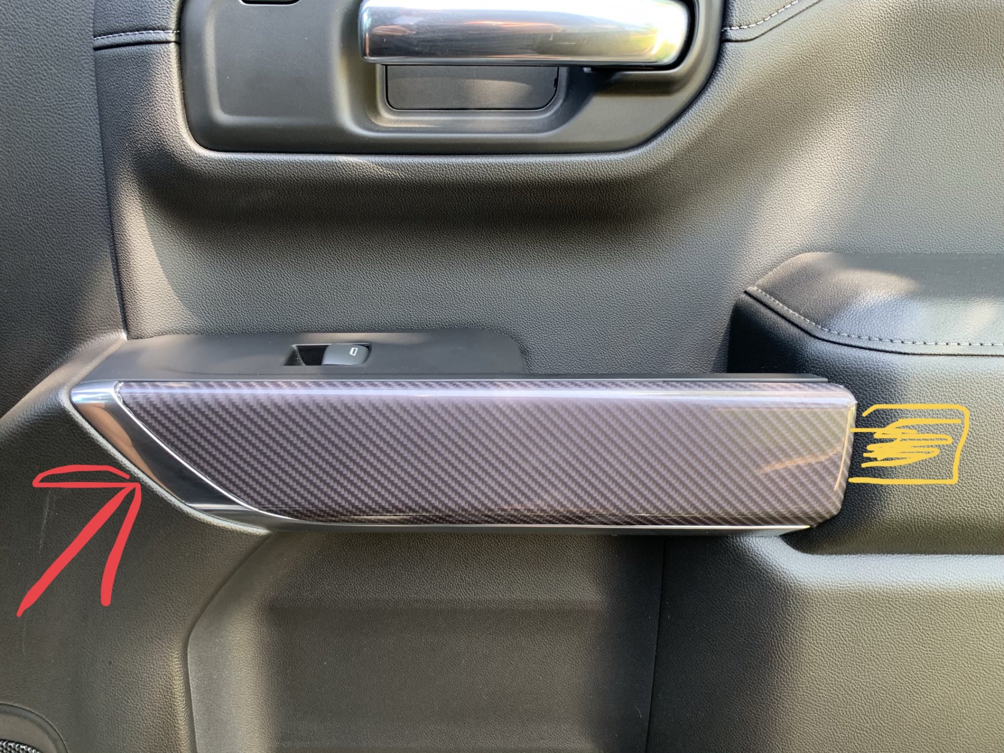

  5. Did them myself, Obxman had a write up on it. It’s really easy. Pry ONLY where the red arrow is. There is a tab indicated by the yellow so DO NOT PRY there. Amazon has every vinyl pattern imaginable. Just read the reviews for a good one. Think I spent $15. The Z71 badges take a lot more work. Wax dental floss them off. Remove all the 3M adhesive. Then you can CAREFULLY remove the red from the chrome. Paint, then reassemble and apply new 3M tape.

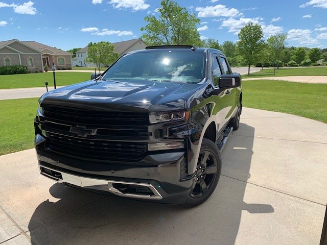

  7. I had them wrapped. A lot of shops wouldn't touch them, said they were too complicated (the Grill). When I walked in to the last shop and saw the guy wrapping a new McLaren I figured he knew what he was doing. Eventually I'll probably swap the out for painted bumpers from a wreaked truck. New bumpers from GM are too expensive right now.

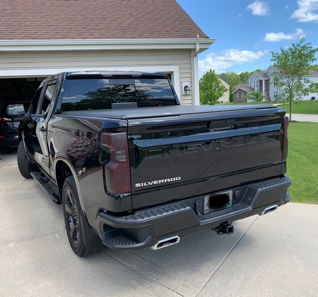

  10. -Access tonneau cover -Dealer sprayed bed liner -Westin side steps -Chrome delete front/rear bumpers and side mirrors -Added chrome piece below the bumper -blacked out Z71 badges -Tinted tail lights. -Stubby antennae -AVS vent visors -Carbon fiber vinyl over the wood grain on the doors (shoutout Obxman7) -Illuminated Bow tie (shoutout BeardBros) -Window tint -Xpel’d the hood -Swapped all incandescent bulbs for LED’s -Wheels 20’s from my ‘16 on till I figure out what I want to do for 22’s -fogs coming soon

  13. What the part number for your cover, and does it allow the tailgate to drop automatically?
