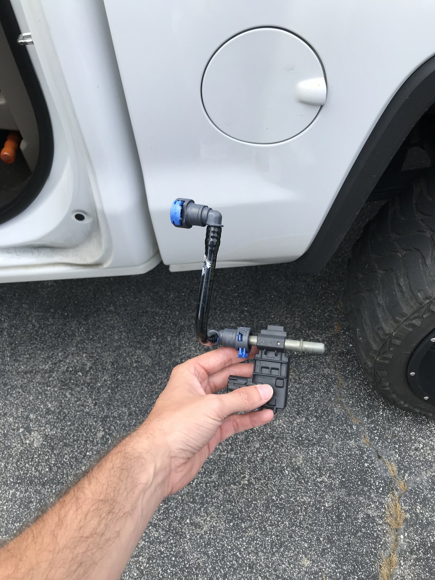

  4. Good deal I just want people to know and double check by logging before you go ripping around. Obviously something when wrong with my line when I heated it up and bent it out straight. .93 lambda might hurt something
  5. I tired the line post earlier again but I spun around the top fitting so the tank line came in from the drivers side door. Something must be pinched or it shrunk when I heated it up to straighten it out. With the line added it makes my WOT go lean. Around .91 to .93 lambda, Then I can come right back home take the line off and go for a log again and it goes right back to where it should be around .87 lambda. This is all checked with my wideband. So be careful. The Russell fitting didn't have this problem but they failed on my after two years. So I'm going to go back to that style and just use the more expensive DSX fitting. You can't go by your STFT or LTFT because it doesn't reference those during WOT pulls. That's why the STFT go to 0% as soon as the truck goes into PE.
  6. Thanks I was thinking about it last night and maybe one of the clips on the top of the fuel tank that hold the soft line in place was pinching that line. I'll hook it up again and spin the soft fuel line around like you have it and log again.
  7. Here is how I had the line bent. If it’s not the new fuel line I guess I could of been punching the flexible fuel line coming off the fuel tank. But don’t believe that’s it. If you logs come back fine. I’ll dig into it deeper.
  8. You could be 100% right. Because like I said the way I bent the line wasn’t quite like yours. I didn’t realize you spun the line from the tank around 180 degrees. just wanted to let you know. Mine was being pinched or blocked somewhere.
  9. Confirmed at lunch that the line was causing a restriction. I removed it and just plug the fuel lines back into there stock spot and my fuel trims went back to the way it was before. I'm going to go with the DXS fitting that is straight instead. I never had a restriction with the Russell fitting that where straight. So I'm going to go back to something like that.
  10. Have you logged you fuel trims after adding this fuel line. After my Russell fittings failed I decided to use this line. But I didn't from memory remember you flipped the fitting coming from the tank. So my sensor it hanging out over the drive shaft. But it shouldn't flow much different than how you have it set up. I've been dialing in my spark since I already had my MAF and VE fueling dialed in pretty good. After the only thing I did to the truck last night was I added that fuel line. Now under WOT my fuel trims read much leaner. At idol and cruising it's fine but I think it's causing a bottle neck at WOT. My MAF error went from -1 to -2 to 8 to 10 and the wideband confirms it. I'm usually around .86 lambda and before I noticed it was lean I was at .95. Not good for WOT I'm going to go out and take it off a log again and see if it goes back to the way it was be for.

  12. Just wanted to update this thread. Don't use the Russell fittings that I originally used. (the blue colored fitting). They will FAIL, mine did after two years of being on the truck. This weekend I went to unhook my boat for the truck and it would hardly run. When I opened the drivers side door it sounded like a shower under my truck. When I cycled the key to the on position but didn't start it. I was spraying 40 psi of fuel on to the ground. Luckily I wasn't running E85 at the time so I was able to just unhook the sensor and plumb the stock ones back together. Use the DSX fitting or try the fuel line above. I'm going to try that one the bent fuel line. It looks OEM
