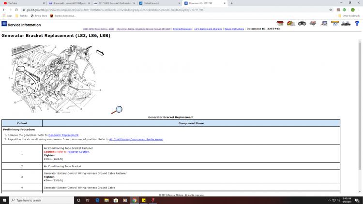

yea im pretty sure, considering ive done it. i am a tech for a gmc dealership. you move the compressor. the bottom bolt /stud has to to come out to remove that bracket , the compressor attaches to that bracket . the water pump manifold runs behind the bracket. if you look at the picture you posted you see a big metal bracket that the compressor bolts to, the water pump manifold runs behind that. Remove the generator. Refer to Generator Replacement. Reposition the air conditioning compressor from the mounted position. Refer to Air Conditioning Compressor Replacement. 1 Air Conditioning Tube Bracket Fastener Caution: Refer to Fastener Caution. Tighten 22 Y (16 lb ft) 2 Air Conditioning Tube Bracket 3 Generator Battery Control Wiring Harness Ground Cable Fastener Tighten 45 Y (33 lb ft) 4 Generator Battery Control Wiring Harness Ground Cable 5 Generator Bracket Fastener Tighten 58 Y (43 lb ft) 6 Generator Bracket
