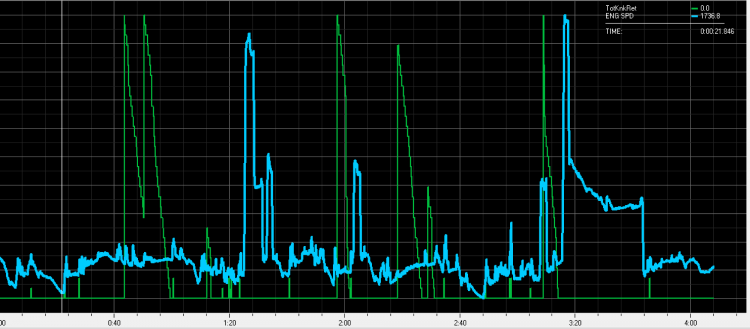

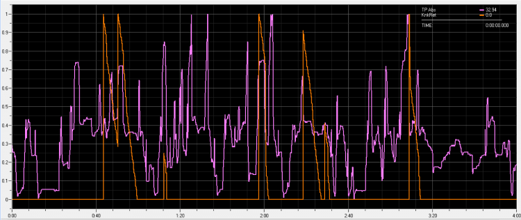

@Grumpy Bear thank you. I found one interesting fact today while trying to troubleshoot. I just went for a long drive and logged again. While logs shows few KR events, up to 4 degrees. There was no audible pinging, same tank of fuel, same load, same route. What was different - the outside temperature, it is finally cold in NC, outside temp was ~42. I could not hear a single pinging event, before it was very audible almost all the time. What sensors might be to blame here? I thought maybe active shutters on Tahoe do not open fully but temp gauge does not show overheating ever. Is MAF also a temp sensor?

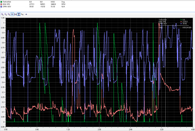

Good time of day- the graph below shows both spark timing advance and total knock retards. Are these timing advances normal?
Good points and: 1) catch can from day 1 and it does catch but not water or milky stuff but oil with some fuel in it 2) plugs look OK 3) it consumes with Mobil 1 EP but not more than 1/3 of a quart over 4500 miles and zero consumption with Rotella Gas Truck 4) CRC Intake Valve cleaner was run through the intake 4) did not check the compression

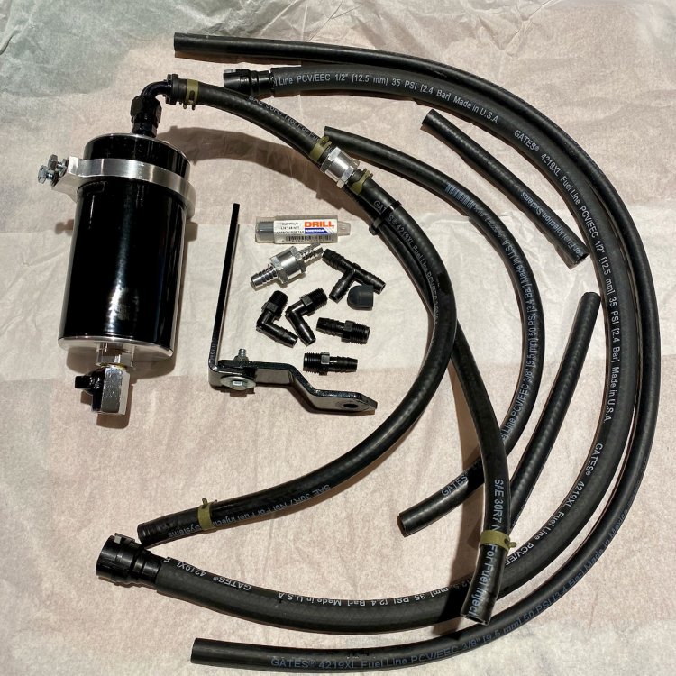

SOLD The kit includes our billet aluminum check valves. If you are generating more then 12# of boost, you should opt for our high performance check valve. You will only need one to go on the intake manifold side of the system. The other side will still utilize the standard check valve. The Standard hose is Gates Push-Lok. This is a high quality hoses cut to fit Tahoes, Yukons, etc. You can replace hoses for $10 to get different lengths. https://rxcatchcans.com/ols/products/tracy-lewis-signature-series/v/TLP202
Indeed, I can hear it, I pay attention to my truck, in fact too much attention, I baby this machine, perhaps better to gun it down and drive like a maniac that will keep the plugs clean, IVD burnt off and oil pressure up. It is very irrational that I like GM products, my Yukon was a Lemon, this one it generally OK, some rattles and pinging. These full size trucks do drive nicely on highways and they are SO quiet that I can hear pinging very clearly.
Understood. The most annoying part that it happens at the exact crusing RPM and if I tip in to maintain speed it happens almost all the time, to avoid it I have to press harder to downshift breaking the cruising.
No codes ever, not even short-term. What concerns me that it pings even on 89 sometimes.
Hope someone can help me troubleshoot it. 2020 Tahoe LS with 5.3, 6-speed, 31K miles. I have tried Exxon, Mobil, BP, Shell 87 gas. On 87 and often on 89 truck pings on highway trips, I am cruising 65-70 MPH, engine is always hovering around 1800-2000 and when I am trying to maintain the speed or add just a bit of throttle uphill it pings for 1-2 secs and then it downshifts and no pinging in the lower gear but once again at 70 MPH crusing around 1900 RPMs, if I am to touch the throttle it would ping/lug. With 89 it happens less, with 93 no pinging. I run Mobil 1 EP, Shell Gas Truck, Valvoline Modern Engine oil with the AC Delco filter. Change oil every 4500 miles. Dealer, of course, " cannot reproduce the issue". This truck is designed to run 87 fine and many many on these forum run 87 with zero knock issues, in my case, unless I run 93 it pings. Pinging is bad, thus what can I do to get the dealer/GM to accept the issue and fix it? With gas prices at $4.50 for 93 grade, it is now very noticeable to fill up as Regular vs. Premium is $1+ spread. Appreciate thoughts. Here are the logs from September for Knock ****** events. The CSV file is here as well Driving Logs with Knock events

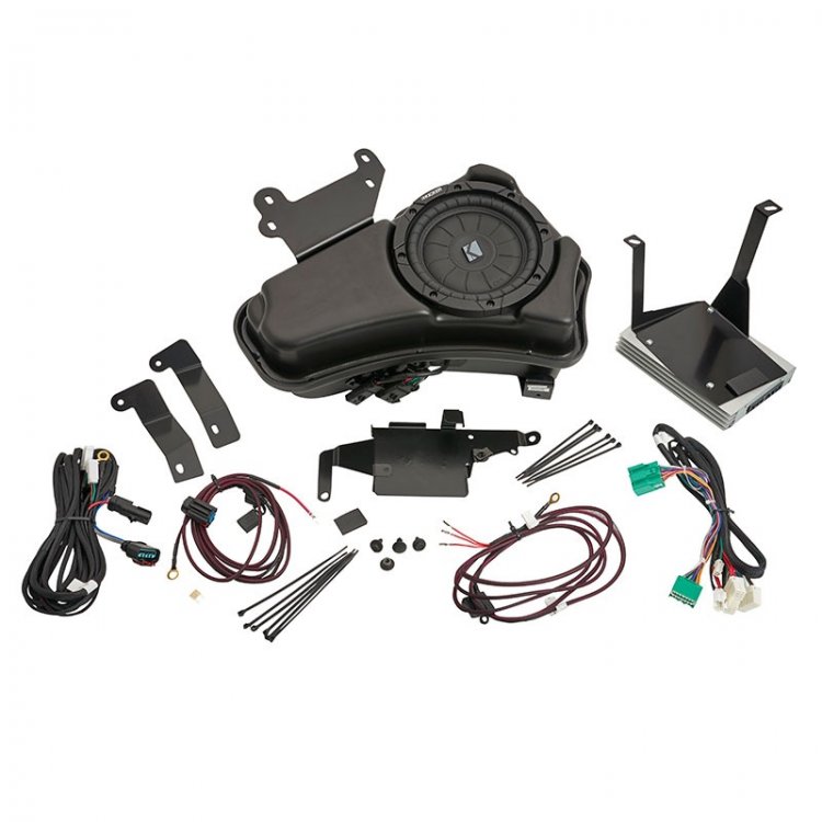

CHEVROLET TAHOE GMC YUKON AUDIO UPGRADE, KICKER® 200 WATT AMPLIFIER AND SUBWOOFER SYSTEM GM part 19355507 Kicker part PSUTA15 Brand new never used or open GM Genuine OEM Accessories Amplifier and Subwoofer system made by Kicker for Tahoes 2016-2020 and many other GM trucks. ( Please note this is the not the cheaper Sub only kit but rather full audio upgrade system with amplifier, DSP and all parts, Retail rice at dealers is $1300. Part # 19355507. Please check gm accessories site for compatibility. It retails for $900-$1300 new on eBay and at dealers, I paid $930. Selling for the price of $625+shipping. The parts are sealed and never opened. I bought it for my 2020 Tahoe, but I do not have time to install it. It is plug and play according to GM.

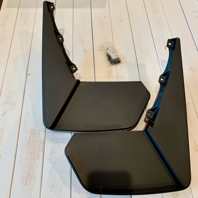

Genuine OE GM GMC Mud Flaps Splash Guards for GMC Yukon. I bought them for Yukon that was traded in for Tahoe. I assumed they would fit Tahoe but they do not. So assume they are for GMC Yukon only. Year 2015-2020. Please note that I had peeled red cover tape from one guards to see if the guard fits and tape was reapplied. For that I am significantly discounting these. They retail for $50 plus shipping. Selling for $20 plus actual shipping. My loss is your gain. Help protect your vehicle from mud, gravel and road splash with GMC Accessories Splash Guards.
