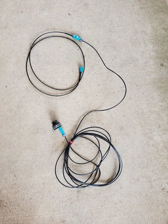

  1. So I finally got the cameras working through a work around. I had to buy an aux camera from Camera Source for $387.85. That got my system working although the camera is not mounted. Since I cannot see the back of the bed, backing up to a trailer without the tailgate on is a hassle since you can't see the ball either. I needed to be able to disconnect and reconnect once I got to my destination to drop off my camper and connect my boat /kayak trailers. I didn't want to be climbing back under each time and again to pack up the camper so I bought an extension from Pasternack. When I take my tailgate off, I connect the jumper that remains in place routed through the bumper area. I then connect to the other end. I hang the end where the hitch cable goes. I attached a 1/2" tube over the connector to keep dirt out. I installed Velcro under to secure the end. (Note I still use a camera system mounted to my camper that displays all the time to monitor my trailers.) This is an very expensive solution for something GM should have addressed. It's a safety issue when the cameras stop working just because the tailgate is removed.
