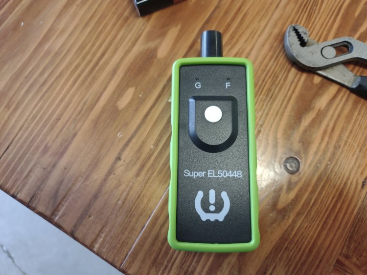

Just traded my 2022 Silverado for a 2026 GMC Sierra 1500. I put my spare rims (winter tires) on the new GMC yesterday and went to re-sync the TPMS sensors, but no go? Using the same sync tool I have used since 2022, there is no response from the GMC when in learning mode? Apparently GM has changed the truck so that the 2022 sensors no longer work? I did try the sync tool on my 2022 cadillac and it still works perfect. Looks like I need (4) new 2026 compatible sensors.
