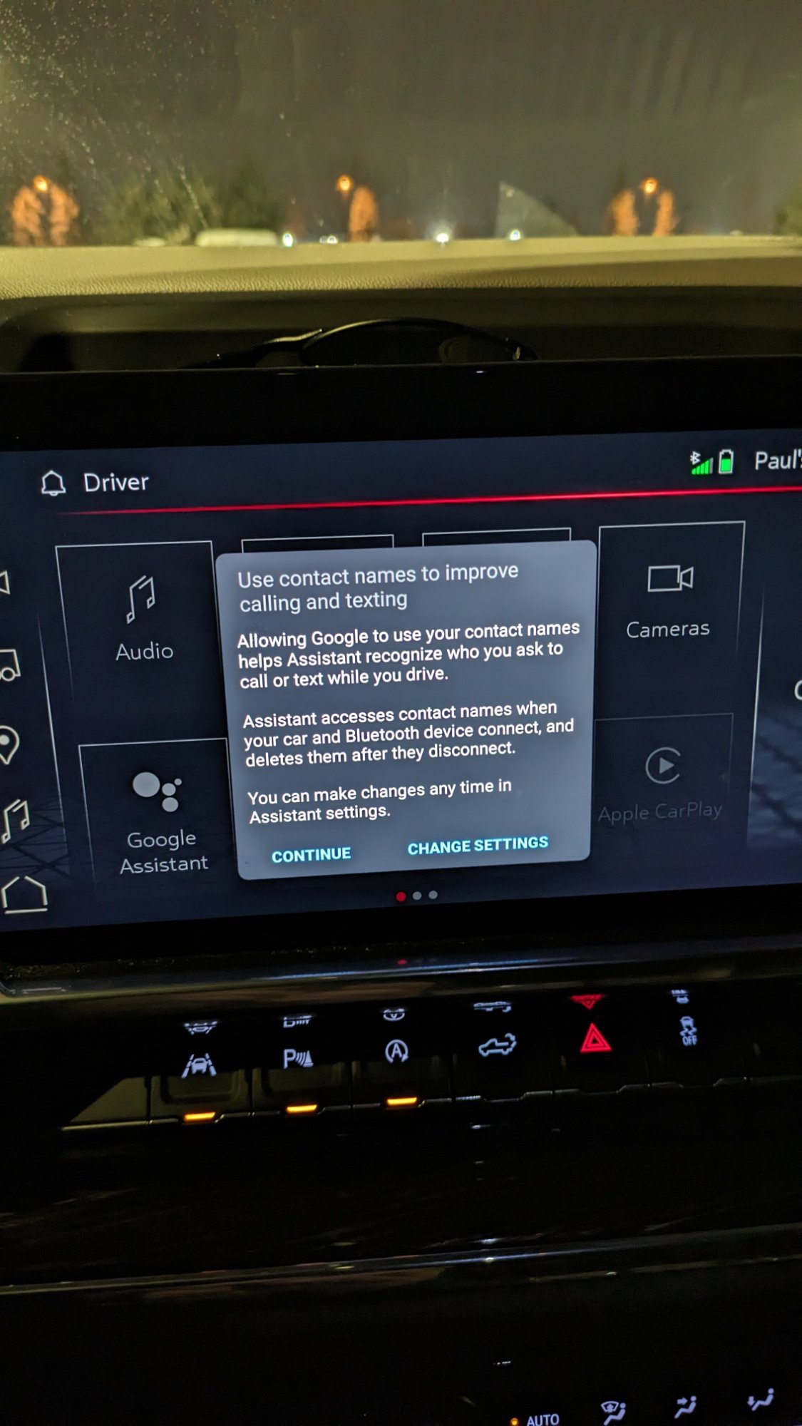

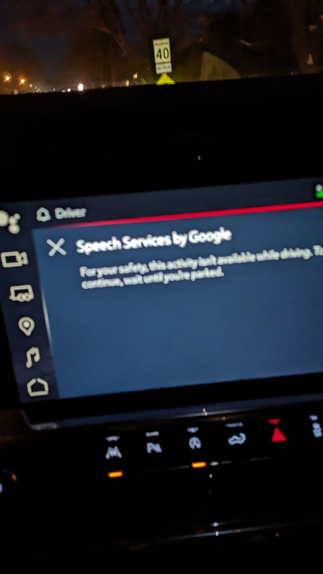

  12. Disabling the Alexa app fixed it for me. But, I've also disable Google assistant as I don't have a data plan (gets rid of the speech services message at startup). You can try disabling the assistant and see what happens.
  13. It's the Alexa app. Go into settings, Apps & preferences. Find Alexa and click on it. Hit the disable button. GM bulletin #PIT6032. Disabling Alexa is the solution in the first release of that bulletin. The subsequent versions of the bulletin don't mention disabling Alexa. Makes me wonder if they got in trouble with Amazon. Did it on mine. It's not a 100% fix, but the frequency of it happening is much, much lower.

  16. Figured out how to get rid of the messages shown below: Go into settings -> apps -> all apps Look for Google assistant and press on it. Hit the disable button. Done. You'll lose the native maps and a few other apps, but you can't use them without a data plan anyways. Android Auto still works flawlessly.

  21. I often get these messages when I start the truck. What setting needs to change to avoid them? I don't have onstar or any data for my truck. Thanks
