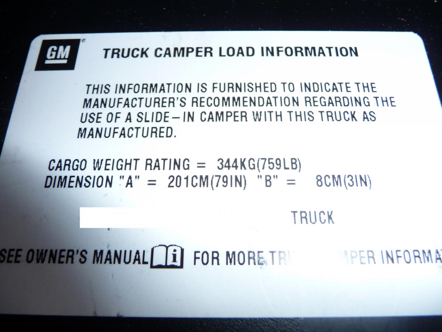

There's got to be more to it than that. My 2006 GMC Sierra SLT K1500 1/2 ton X-cab Short Box 4x4 Z71 says it can take a camper and also a 5-th wheel. (Well, not at the same time, I guess.) Pages 4-70 thru 4-82 of the Owner's Manual give specs for trailers and include notation for 5-th wheels. Pages 4-59 thru 4-61 give specific instructions for campers. Attached is photo of glove-box label with specs for slide-in camper. Although admittedly a 759-pound camper isn't much. My truck has the "heavy-duty" trailer package also, maybe that makes a difference - ?

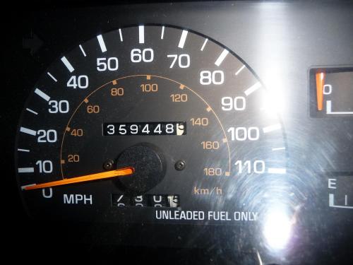

I only have 145,00 on my 2006 Sierra, but my 1990 Toyota 4x4 has a little over 360,000. Speedo pic below shows it at 359,00 and change, but I've added a little since then. Think about it, that's 14 1/2 times around our planet. -
