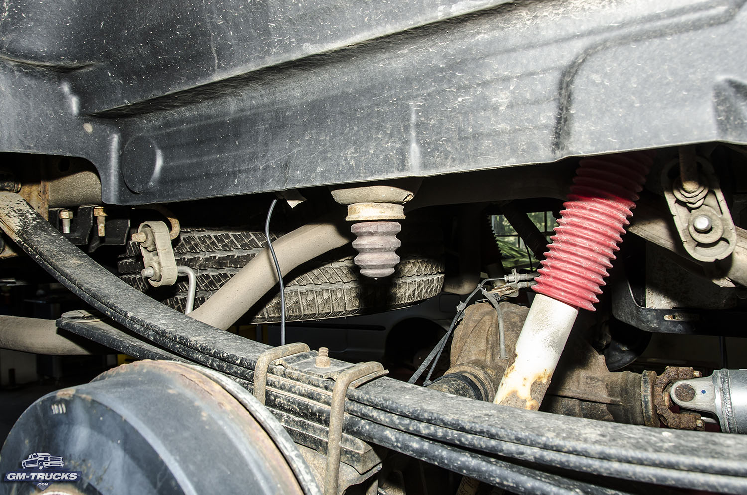

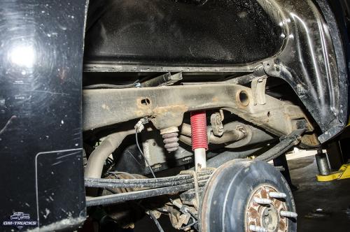

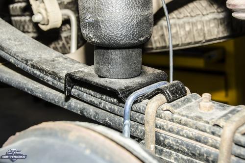

First we removed the rear tires, the rear inner wheel well liners, and the rear spare tire.

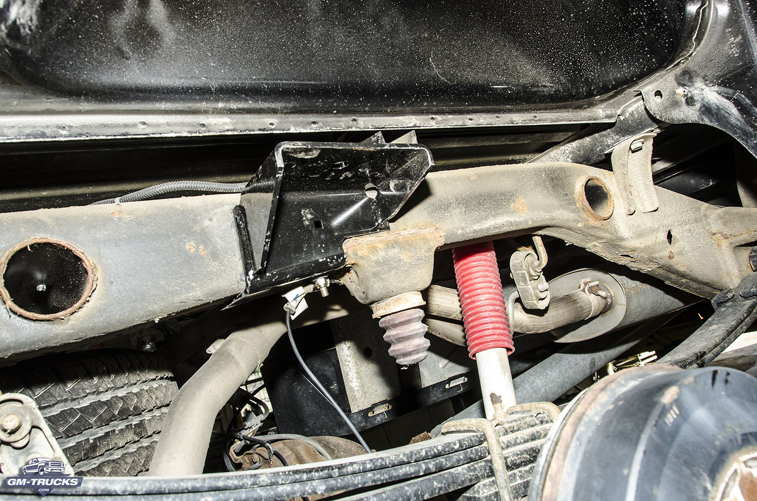

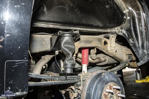

Then we mounted the brackets to the frame and leaf spring along with a deflated airbag.

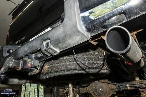

The next step is to run your airlines. Both bags will be connected to the same compressor. We ran the lines from each airbag to a ‘T’, which in turn had another ‘T’. One end of the hose will be run to the air compressor while the other is tucked behind the rear bumper and equipped with a schrader valve for emergency manual inflation.

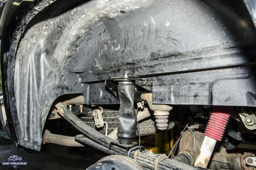

We then carefully cut the inner wheel well liner to fit the mounting bracket and reinstalled it.
We then installed the air compressor and controller manifold under our spare tire. We chose this location because it was protected and far enough away we cannot hear the compressor running from inside the cabin.
Lastly, we ran the wiring harness to the engine compartment and connected it to a keyed power source.
After we confirmed the system inflated the airbags and none of our lines leaked, we reattached the wheels and buttoned the project up.
