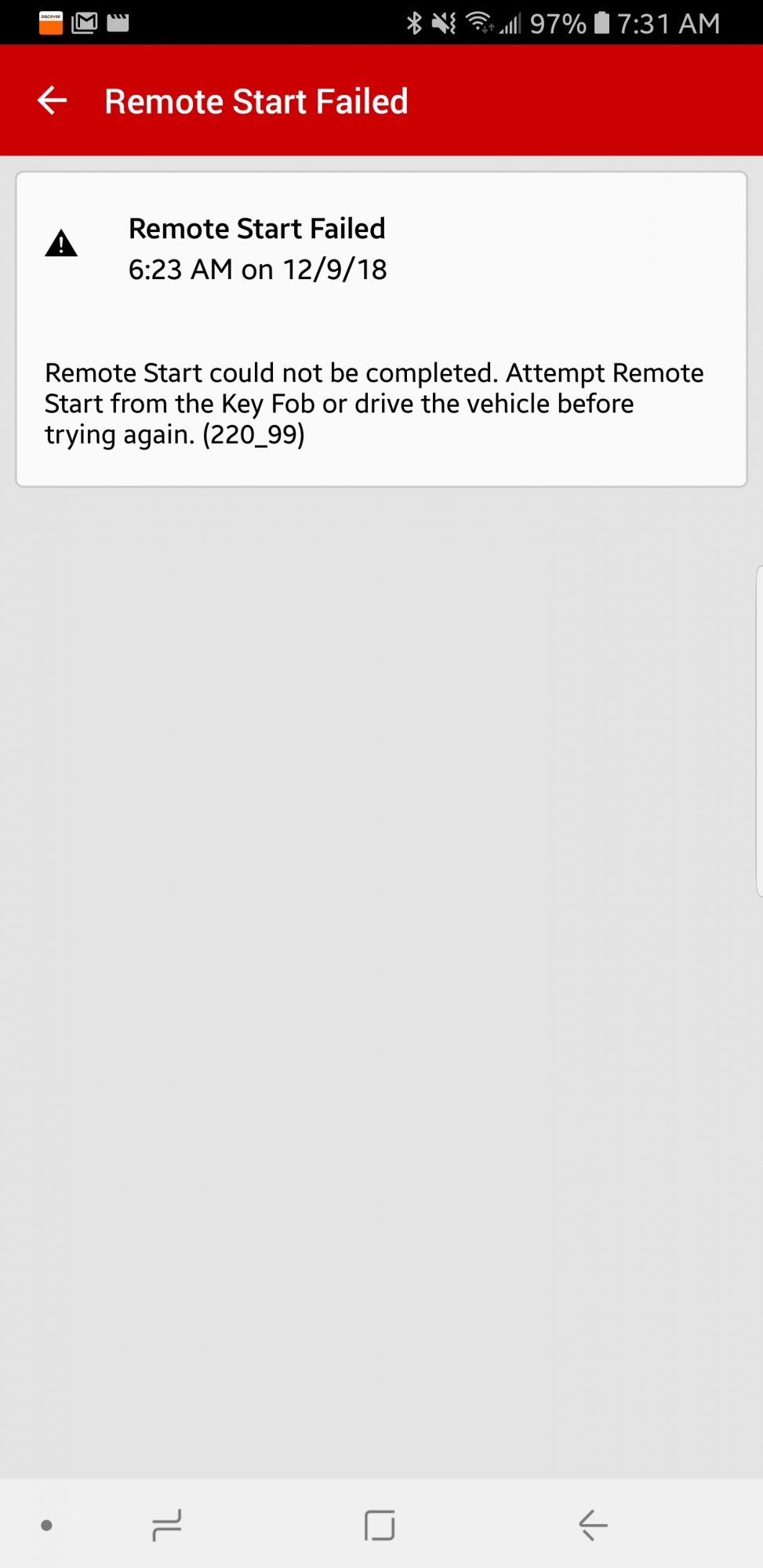

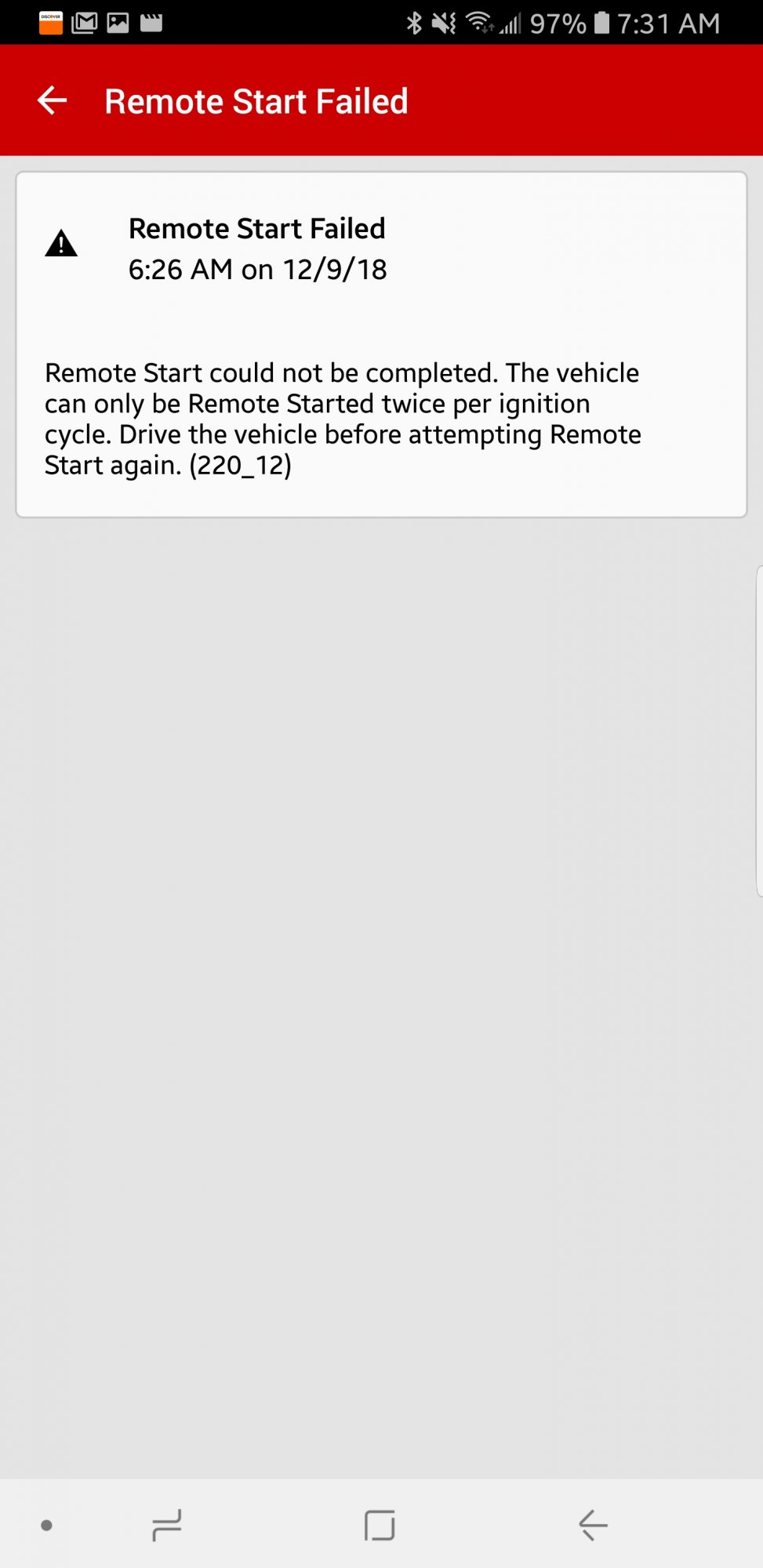

Back again, next winter season, same issue. Completely random no starts via fob. I don’t have app access unless they offer a free trial. I haven’t taken it to the dealer yet, but I will soon. I only use the remote start in winter and everything was going well, until it didn’t start before leaving for work (11/22/19). Since then, I started an excel spreadsheet with date, time, temperature, method (fob 1x/2x or key), failed ( Yes or No), and info columns. The 1x/2x for the fob is my way of keeping track if I only used I once or hit it again to get another 10 min of warming up. All entries are 1x. Thinking about it now, I should have kept track if it was running or not when I put the key in and left. I kept track of every start, even with the key. I was hoping to see a pattern or something that I can take to the dealer to help pinpoint the issue. On 12/19, it started fine with the fob. Made a stop at a gas station 15 min later and used the key (log entry 37) to start it. When it was cranking, it just stopped like I let go of the key. This isn’t the first time this has happened either. I noticed it a handful of times since I owned the truck, random times, random seasons. The next failure came at log entry 100 (weird lol) and it was via the fob. Same story, lights flash once. Since entry 100, I’ve only been keeping track of remote starts. Today, entry 120, 10 degrees, failed with fob, lights flash once. I was pissed off all the way home lol. I have zero faith with my dealer and when I take it in next, I will go to a different one, hoping a different set of eyes may solve the issue. I know there are wiring diagrams out there, but does anyone have a ladder diagram of the remote system? I’ll trouble shoot it myself (not the dealers way of trying it a few times and say “looks good to me”). A ladder diagram would be beneficial so I can see what permissives need to be met in order for the fob to work. Plus what volts or ohms the items require to tell the truck to start via the fob because all conditions are met. I know hood, doors, low oil, low fuel are some, (all?) until then, I’ll continue with my log. Since this has started to be an issue and the sometimes random key start hiccups, I’m leaning towards a bad ground. Somewhere. -

Back in July, I traded in my 14 Silverado for an 18 SLT premium plus. Been more than happy with the upgrade. Since it's cold, I've been using the remote start when needed. Noticed the issue a while back when I tried using the fob walking to my truck after work. Lights flashed and nothing. I dismissed it at that time. Worked via fob or app for a while and then it didn't again. So I took it to the dealer. They couldn't replicate it but did do an update that addressed the crank position sensor. A week or so of starts remotely worked, then it didn't again. Most recent failure was this morning. If it fails via the app it gives error 220_99. If I try again with the app it is 220_12. The 220_12 (I think) is the same you get if you remote started twice and tried a 3rd time without using the key. One recent failure via the fob (after the dealer), I was in my garage and I heard it. It sounded like you just bumped the ignition. This will be new info when I go back to the dealer, but I'm wondering if someone else had this issue?

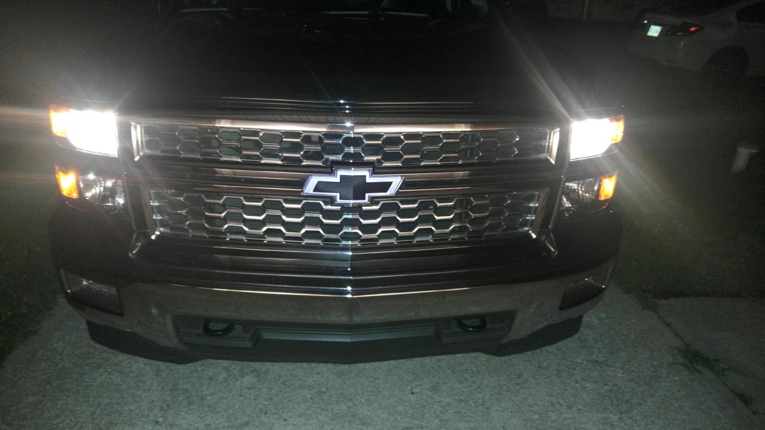

Wash, clay bar, wax and glow-tie install. Didn't put the black emblem on back yet, can't find my fishing line. Headlights and fogs are next project. -
10/18 diode jump gets them on with high beams. 10/22 gets them on with parking lights
