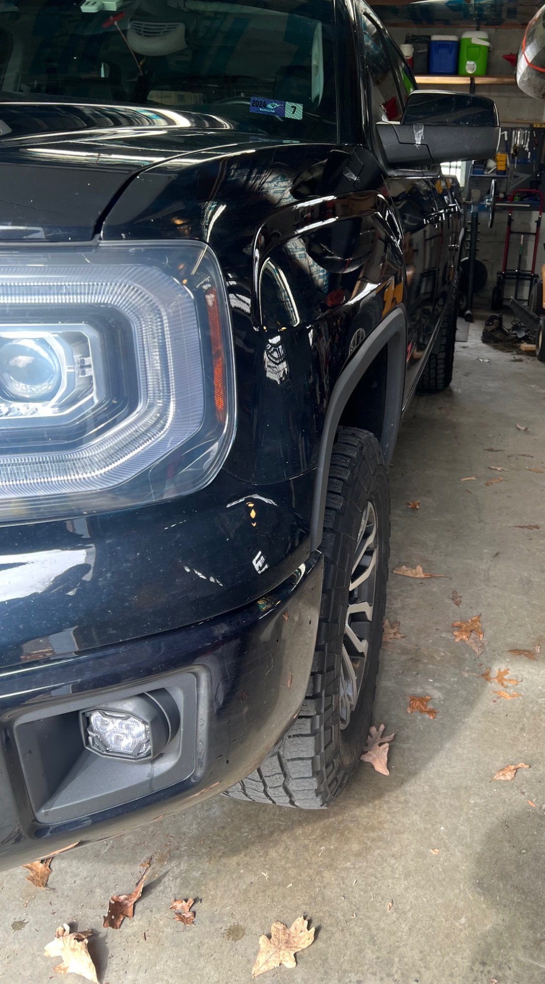

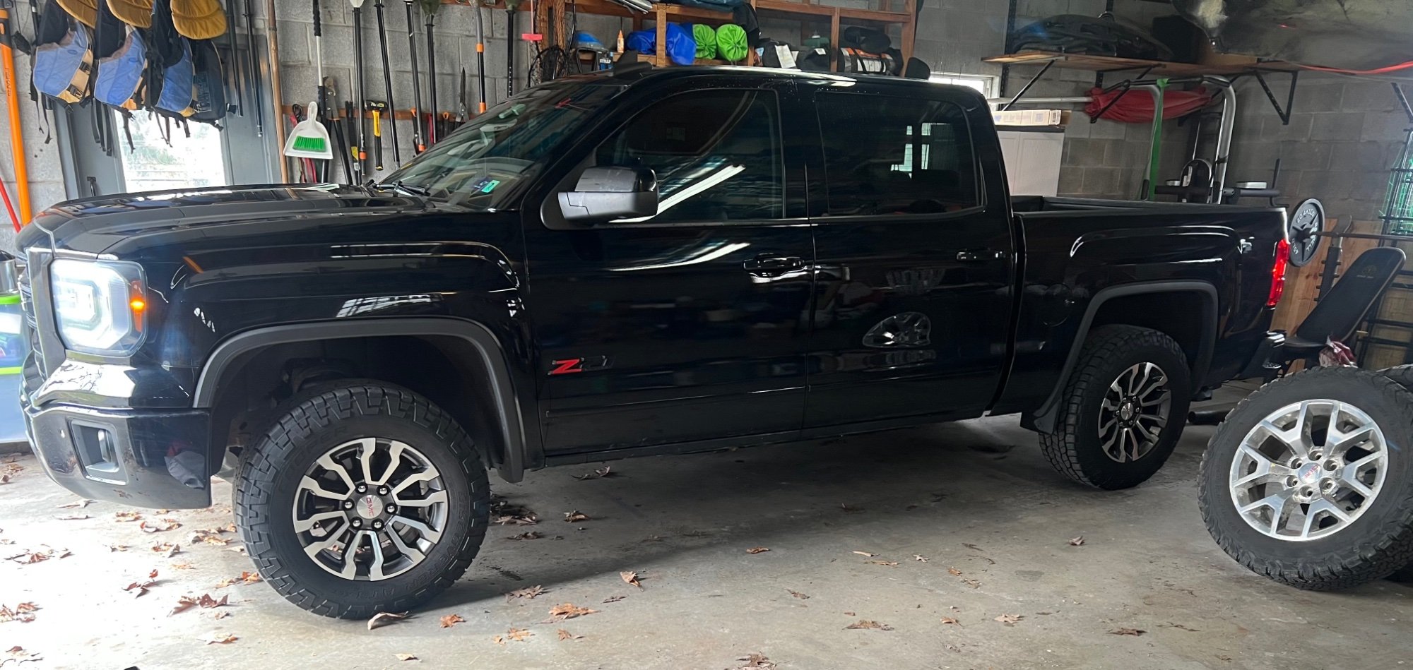

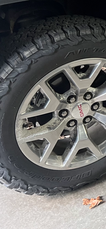

CPR Time, bringing this to life again. Put some 2022 AT4 takeoffs on my 2015. My DIC shows the pressure for each tire, I figured it would not. Only problem is the numbers are all off. Using a pressure gauge they all show 35-36, but the DIC shows 30-31 for them all. I tried a hand gauge and also went to a gas station and used theirs off the air pump, both were reading 35-36 psi. What do I need to do? I will also add I swapped these in my garage and only have driven maybe 5 miles on them. -

Finally swapped out the 9 year old stock 20s. They were ate up from the clear-coat getting compromised and moisture getting under it over the years. Put on some at4 18s, really happy with them. -

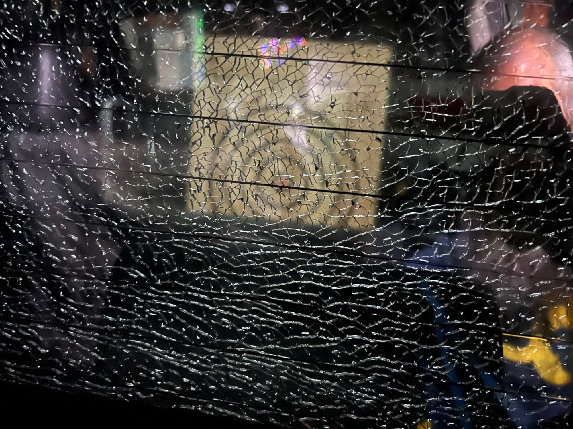

2015 slt here. My driver rear window exploded last Saturday while driving home that evening. Sounded like a gun shot, my wife looked around the back seat but couldn’t see anything wrong, I kept driving. Got home out of the rain and checked it out in the garage, noticed the entire driver window was being held together by tint. Didn’t smell or see smoke. Did use defrost initially to clear fog off side mirrors, but I do not know if it was still on when this occurred. It happened about 15 minutes after we started driving.
