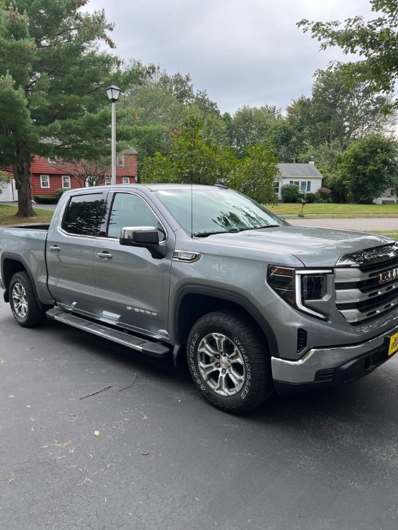

Thank you everyone for your post’s! I retested my signal skills this morning going to breakfast…and it worked! l was holding the signal stock down too long, more than a second. Thanks for saving me an embarrassing trip to my dealership! (Which is 30 miles North)! This is my second 1500 with the 3.0 duramax, I ready like all the small improvements over the 2020 1500 LM2 and the interior was worth the trade alone. Can’t wait to get some miles on the truck and tow my trailers to see how she handles. Thanks again to everyone who posted!! -
Just traded my 2020 Chevrolet 1500 LT for a new 2023 GMC Sierra 1500 SLE. One feature I noticed missing was one I enjoyed on my 2020 is the turn signal touch to pass 3 blinks per touch, 6 when in tow/haul mode. This feature is completely missing on my new truck? Is this normal or did GM change something? Going t contact the dealer but wanted to see if this is normal

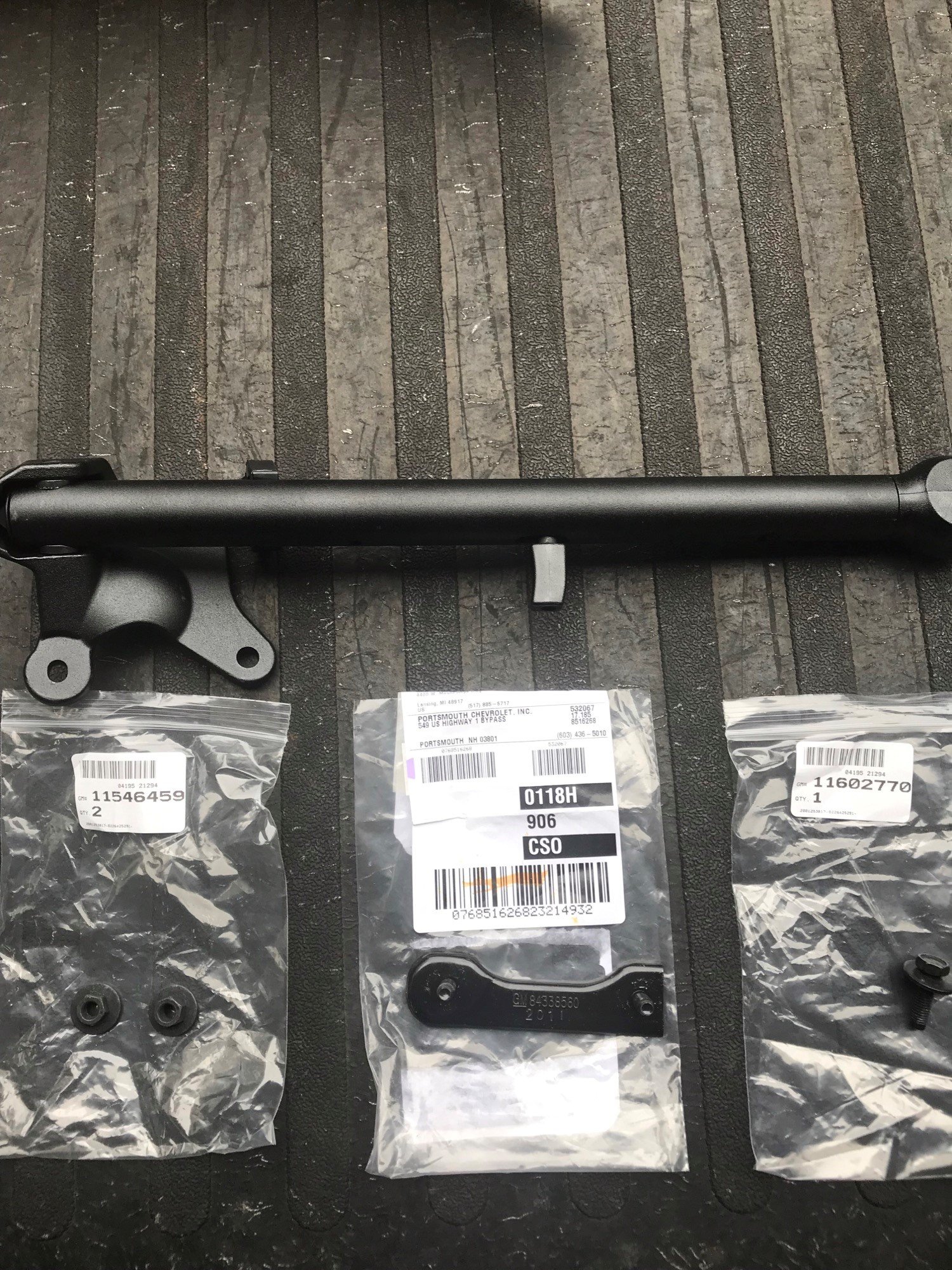

Well I no longer than sent this out and I got a call that my parts were in so here yo go: Parts required for my truck's steel box with the one piece tailgate: Tailgate Handle part number is now 84726114. Hardware for factory DIY Tailgate Handle install: Backup plate bracket 84338560. 8mm-1.25 nuts for backup plate 11546459 (2 required) 8mm-1.25x 24.5 long bolt for truck box 11602770 (I re-tapped the box threads as my factory spray-in liner required it) Works great for me, hope this helps!
Ordered my Tailgate Handle a week ago from my dealer and I can confirm it doesn't come with the hardware. I will post the hardware part numbers as soon as I receive my order and confirm the three hardware part numbers. BTW the correct Tailgate Handle part number is now 84726114. I'll also will post some pictures of all the parts before it's installed as it's a simple install. Looking forward to try this handle out as I'm having trouble accessing the truck's bed area.
