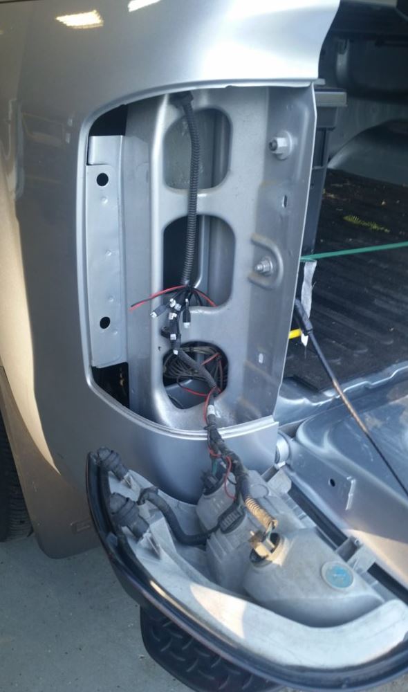

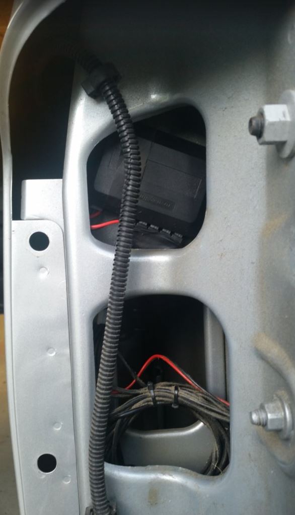

  7. I went with these sensors. They look nearly identical to the factory ones. I only wanted the audible alarm. Several come with a distance gauge, too. All these kits come with a hole saw. I have the speaker attached to the support of the rear seat. Wiring is under the carpet. There's a relay under the dash so the alarm only works when the ignition is on. I didn't like it beeping at me when I walked behind the truck after unlocking it. The reverse lights some on with the courtesy lights. The sensors' controller is tapped into the reverse power and ground wires behind the left tail light assembly. http://www.ebay.com/itm/US-4-Silver-Parking-Sensors-Car-Backup-Reverse-Radar-Buzzer-Alarm-Assistant-Kits-/142329141255?hash=item21237a5807:g:~Q4AAOSwtfhYrqQm Sensor wires ran to the tail light area: Controller mounted with 3M d/s tape:

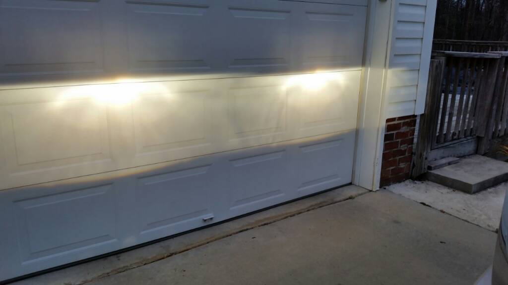

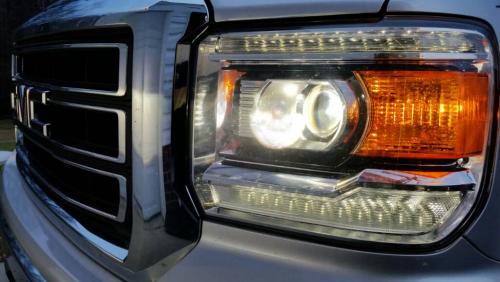

  23. I went with the capacitor link on my 2014 SLT. No problems so far. I've been running them for 3-4 months. The color I chose was the 5500k. It's not an exact match to the LED DRLs, but pretty close. I think the angle you look at the lights with the stock projector changes the perceived color somewhat. It's more blue at that cutoff and white down below.
