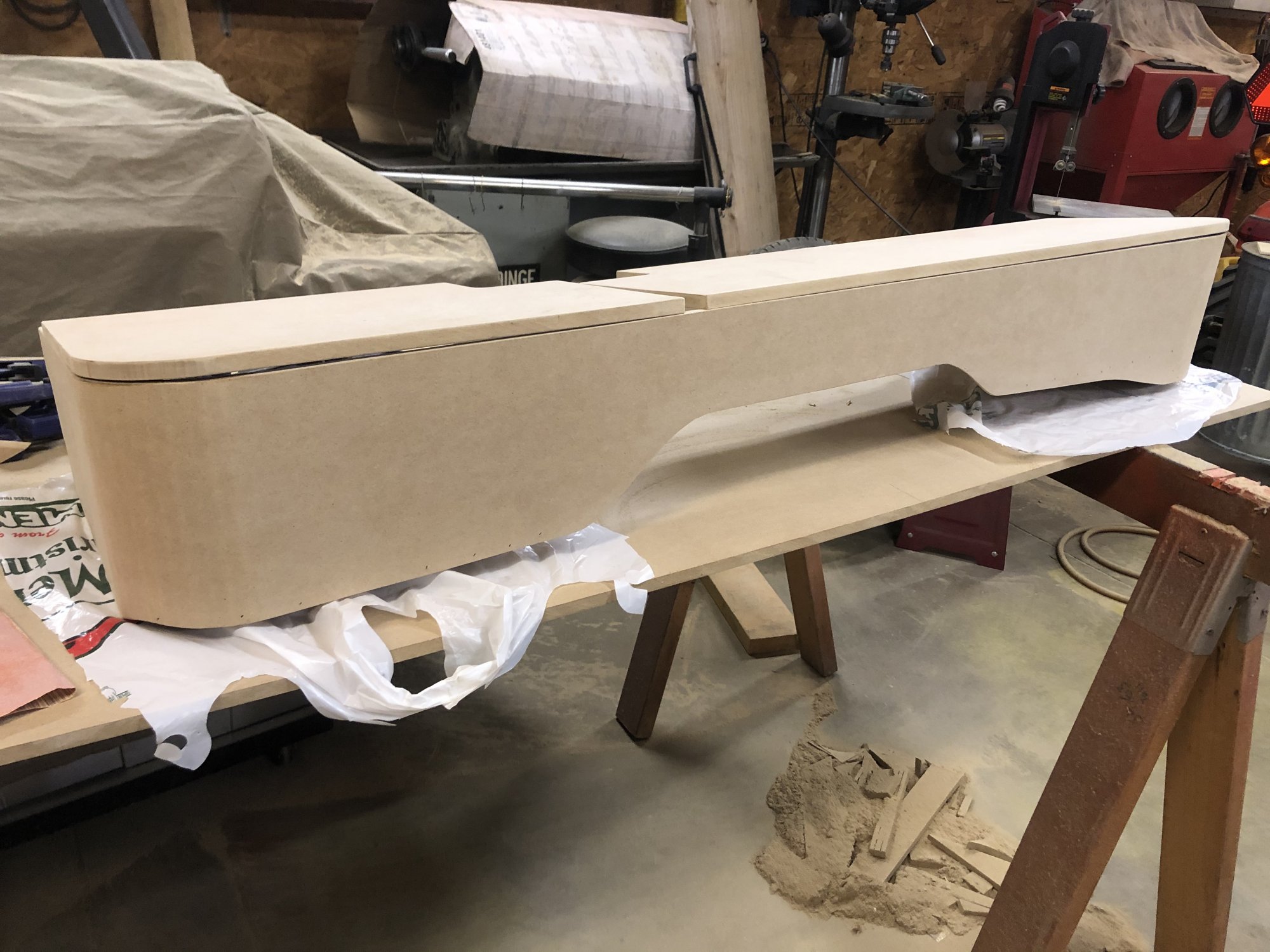

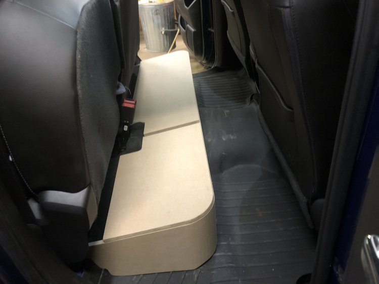

  1. Done building the box. Added a filler piece between the lids.
  2. When I first saw the Trail Boss, I thought it was a work truck package. My brother’s 2010 Silverado WT has the same cheap looking black grill and bumper. In my opinion, the Trail Boss should have the color matched front end like the RST.

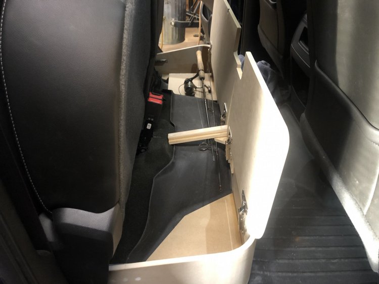

  4. The lids open forward and the hinges have a quick disconnect feature so the lids can be removed.

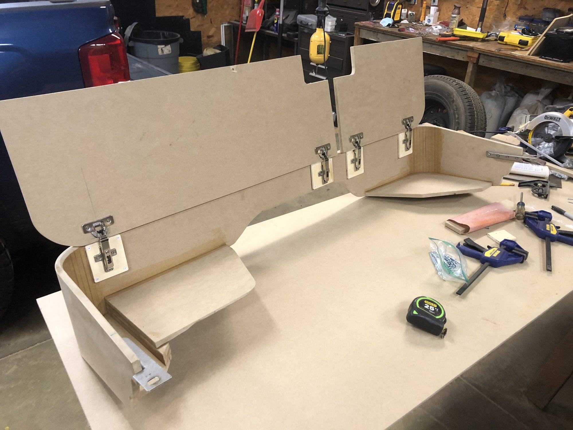

  5. Made the brackets out of stainless.
  6. Thanks! Been meaning to build this for a while. Too bad the double cab floor is nowhere near as flat as the crew cab. Got the lids hinged and made brackets to attach it to the seat bolts. I made it with two lids so that either side can be opened without raising the entire seat.

  8. Worked on building an underseat storage box for my 2016 double cab.
